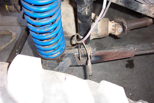

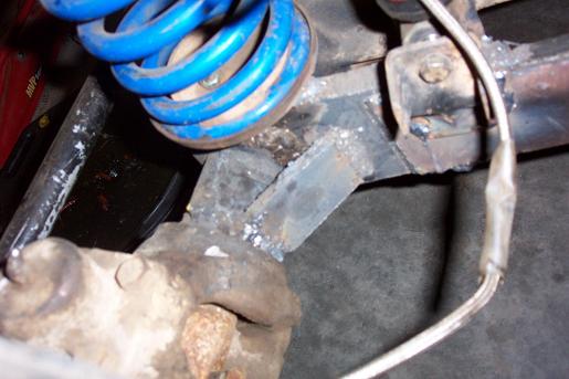

WEll here are the pics i promised! Her is one of the arms i built. the other side has the wriste arm on it so i was able to weld the arm strait to the axle. I had to do this because there was no room for the other brakcets. I did put the wriste arm on the driver side first so i could have a bushing in there but that was stupid because it made my pinion drop even more when the driver side would drop so it would bind instantly! So nows its back to normal. Also the 60 is way more off set to the driver side so i had to pull the t case over alot to get the driveline somewhat strait.
some of the extra bracing.
and the last one of that arm.

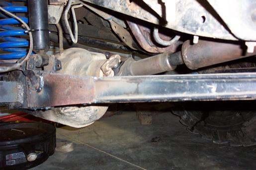

I had to shorten the pan hard bar so i cut a little chunk out of it and sleaved it. I had to do this because i moved my arms in some more because the tires were rubing on it. Anouther advatage to the pumpkin being more off centered is that it wont hit my exaust any more!

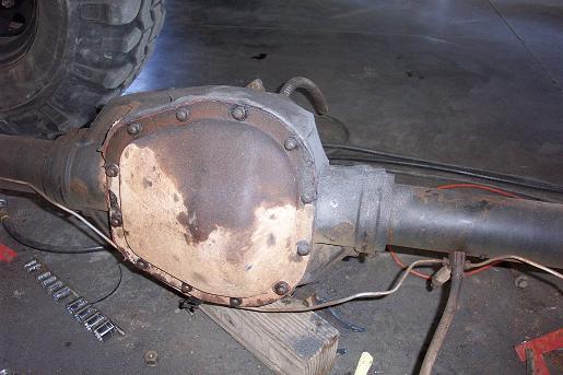

here is the rear axle and what i started off with.

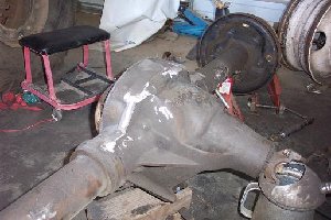

heres some of the fat trimed off!
And here is the other side all gone

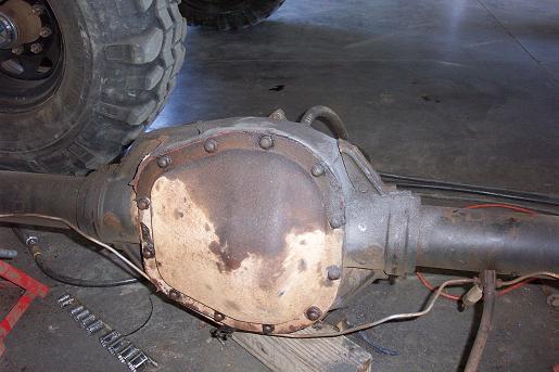

NO more lip!

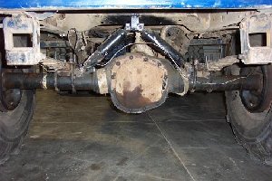

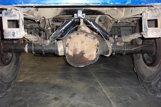

here is a pic of it under my truck. all i had to do was move the spring pearches over and make new shock mounts and take an inch out of the drive line. I also had to build new thingy for the u bolts to go threw!
