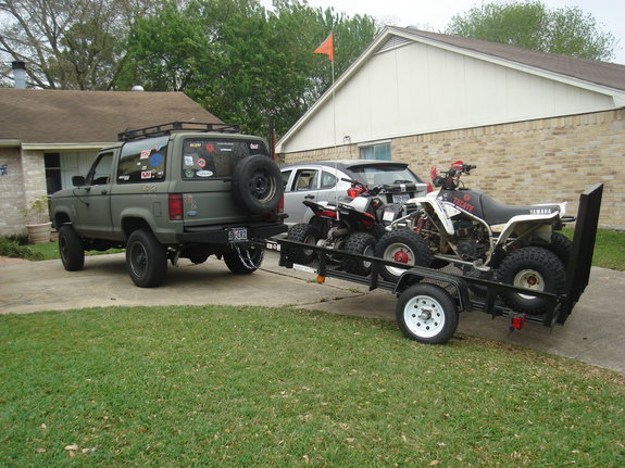

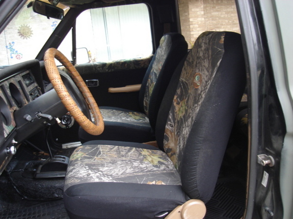

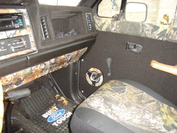

88 B2 2.9 A4LD TRANS.OD GREEN W/CAMO INTERIOR

i love the interior
also how did you attach the roof rack ive been wanting one and thought about building one myself but havent looked to see what to attach it to just wondering what you used

4 ALUMINUM BLOCKS DRILLED AND TAPED BOLTED FROM THE BOTTOM W/ LOTS OF SILICONE ATTACH HOME MADE CONDUIT RACK TO BLOCKS THEN COATED WITH BED LINER TOTAL COAST $40.00

thats not a bad setup looks good

that interior is sweet

ya know i really like that one :D that interior is pretty slick nice job

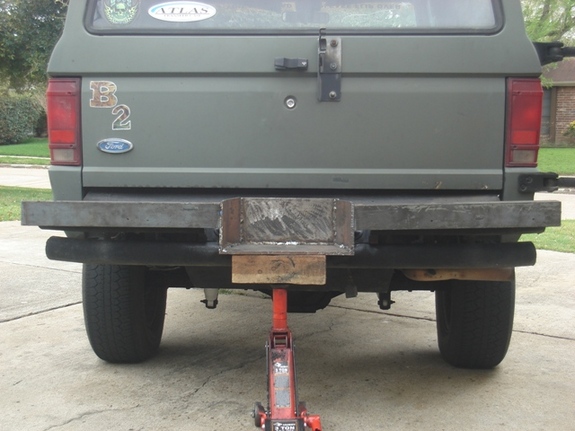

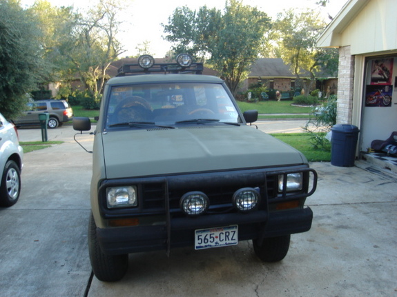

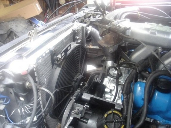

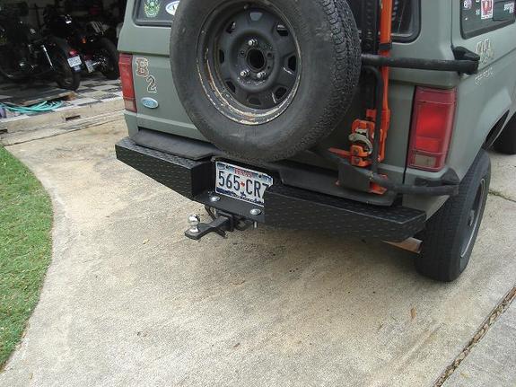

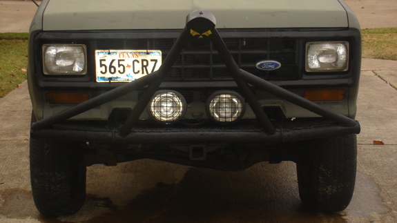

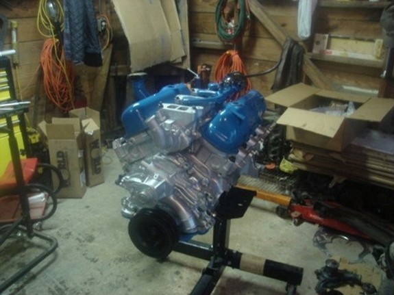

been a while but here are some updates,2" body lift, 2 1/2" skyjacker lift, made front and rear bumpers and rebuilt my 2.9 punched out to a 3.5 with 75 mm pistons world heads ,accel jets,dist and 8mm wires,msd ing,pacesetter headers,explor rad with electric fan and yellow top optima battery
rear bumper mock up
rear bumper mock up

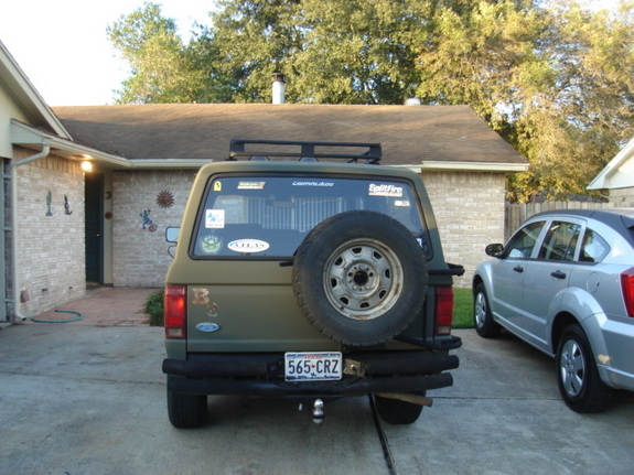

my tow rig
my tow rig

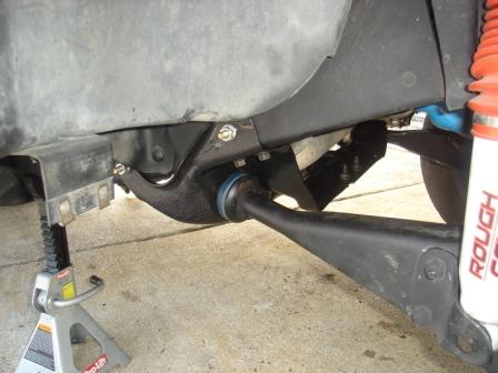

more work

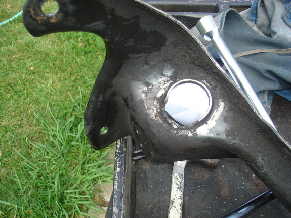

had to replace passenger side radius bracket

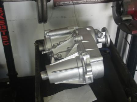

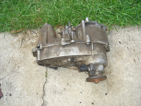

p/u a manual t-case for $75 a little clean up and paint and no more push botton crap for me

cleaned up and ready to go in
