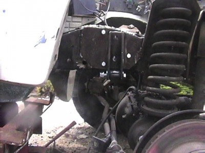

im about to grind the tranny cross member rivots out and i was wondering which hole i use to mount the rad arm brackets? is it one of the rivot holes or the hole thats already there? does the forward hole of the rad arm bracket go to that hole in the frame or the aft hole of the rad arm bracket go to it?

If you can I would try to center the front axle up first with the mounts on the ends of the raduis arms and see which on lines up with the existing hole the best. I believe the front hole of the brackets I used lined up for my application.
I've seen the hole placement slightly different on different BII's.
Mine landed right under a hole. Others the bolt actually will go right in the hole. I agree with Ranger5.0 though, get the axle up there and put it where YOU want it.
When I do it again, I'm going to try to move the axle forward at least an inch. More if it won't affect steering. It really helps with the firewall clearance and all the flex you get from a wristed arm.

i've done 3 sas swaps, 83 ranger,90 B2 and a 98 ranger and none of the holes would line up

On my 88, I aligned the rear hole of a 78-79 Big Bronco drop bracket with the center frame hole of the "inverted bolt-hole triangle". If you go to the link below and look at the 3rd picture down, you can see what I mean. This gave me exactly 94" wheelbase, which I believe is stock B2. I hade to add a slight spacer (10g steel) between the bracket and frame to get the holes to align. I also had to trim the e-brake cable bracket. Of course, your bracket and frame may be entirely different. Finally, if I could do it over again, I too would kick the front axle forward a just a tad.
