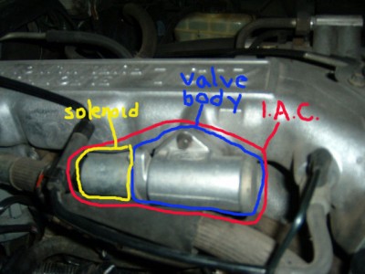

Sorry, what is the IAC valve (the long name) and where is it located? And what is tsb's?

Post by eisle89 »
The IAC ( Idle Air Control ) valve is cylindrical and mounted on the pass. side of the upper intake. Take the solenoid off the end ( the part with the plug ) and clean the valve body out, there will be a gummy residue in there that hinders the valve sliding back and forth. You also say that the fuel filter was replaced 4 years ago, that's a long time. I replace mine annually with the tuneup.

Thank you, this is a great reply and photo is most helpful.
