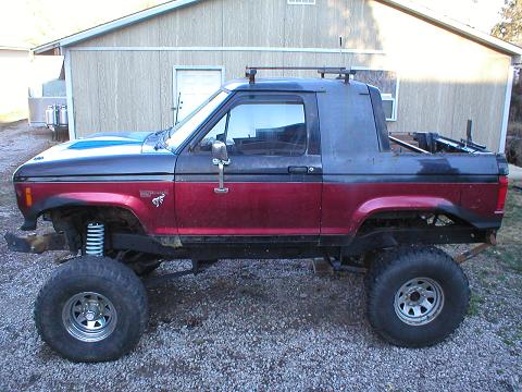

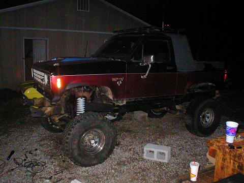

well, I worked all day and got the coils, wristed arm, and drop trakbar bracket on. I think I might be making some drop radius arm brackets though. my coils bow forward a little.
hot damn that's alot of lift, or so it look's that way. are those 35's under there? also did you mount the front core support to th eframe? im thinking od scrapping the mount's i made in the front and just lttinf it be supported by the finders. i've seen a couple of ranger's and s-10's do this.

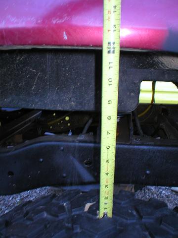

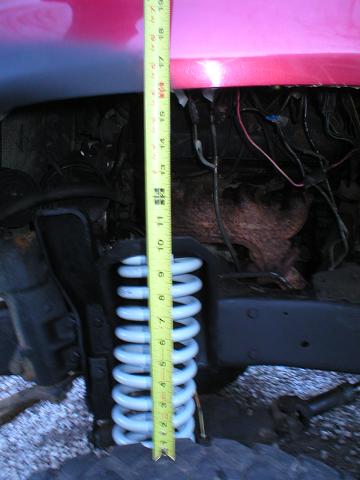

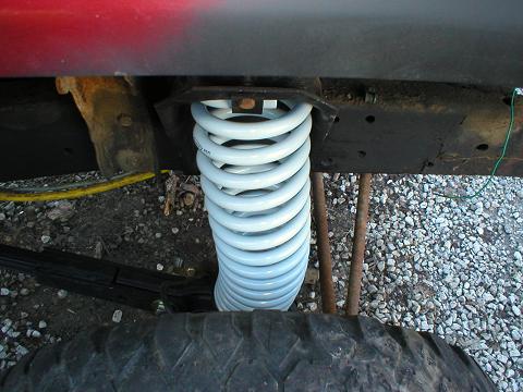

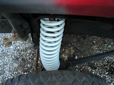

I think I am going to have to run a different set of radius arm brackets. the radius arms are really too far extended to have any flex and the springs are bowed forward from them being in full extension. I think this is because on a BII the front frame has more lift to the rails and that gives the brackets more length between the coil buckets and the spring perch. on mine the frame dosen't have that so the radius arms are maxed. I didn't realy want to run a drop bracket because of ground clearence but I'm thinking this will do what I need it to do.
the other problem I am having is the coils are a little long.......
lift 014.JPG (30.61 KiB) Viewed 10749 times
lift 013.JPG (31.45 KiB) Viewed 10749 times
there is a difference of about 4" between the front and rear. I know they will settle so I will probably take them out for a shakedown run like it sets and see what happens.
yep :cool:

Damn you can run 44 on that bad boy with all that room. :cool:

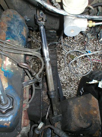

steering is done:

If your radius arms are maxed out I would think about swapping on the radius arm bracket from a bronco II to fix that. The angle it would be on would make it so it wasn't maxxed out like it is now. For the springs you could make you own mounts for the bottom or shim the stock ones to hold the springs right. Just a suggestion if you want to keep the clearnce. You may be able to take the stock radius arm mount off rotate it some and drill to bolt it back on. On mine instead of swapping to the F-150 bracket I just moved the Bronco II's back because of the angle the arms were at.

rotated the steering yesterday and everything worked good. I have a tight clearence between the brake booster and the bolt the holds the steering arm to the column but it looks like it will work well.

I see that you used the fullsize coil buckets. Did you get the shock mounts to? How come you used a different steering box? And last it almost looks like your coils are to tall for the application and thats why they are bowing. You may have to use a radius arm drop bracket. good luck!
