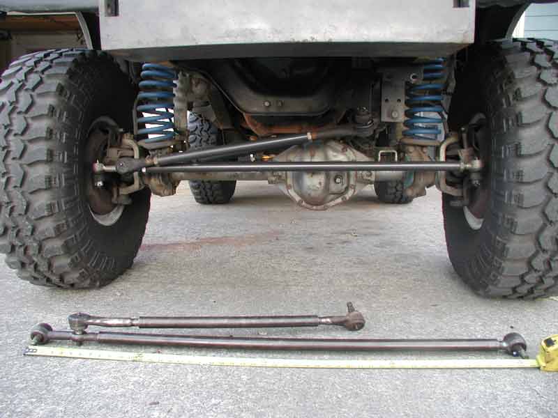

Question... Is there a way to get the ttb steering to work on a d44 or is it different geometry?
DAMNNNNNNN!!!!!! that thing looks but-naked. good work Phillippi is that enough encurragement?? :finger:
i think the ttb steering can be used but might not work as well as the eb steering becuz of the design.
Don't use the TTB steering. If you did manage to hook it up, it would toe in/out your tires everytime you hit a bump.
so should I be able to cut down the stock steering for the FS that came with my axle? Maybe sleeve it or cut an end and weld a new one on?
That should work fine. I ran a cut down tie rod for awhile. Ultimately, you'll want to do the Chevy TRE conversion like I did.
