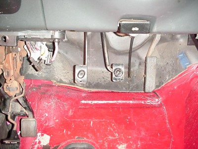

So I'll just put a breather type filter on the end. Here is another question for you, can I add a clutch to my brake assembly, or will I need a whole new one. If I need a new one I'll be making a custum one. I just want to find out before I start fabbing something.
- Posts: 1435
Re: 5.0 Install
i think the(auto) brake pedal is to wide just to ad a clutch pedal. i think your gonna need both pedals. i swapped a navajo over to a 5spd. looks kike theres a enough room for the big brake pedal there
- Posts: 1435
Re: 5.0 Install
nope,your gonna need both pedals. with the auto,the brake pedal has the piviot pin welded to it,with a std,the clutch pedal has the piviot welded to it and slides through the brake pedal. its all commin back to me now
Re: 5.0 Install
Thanks. I'll make something up, and just put a limit switch in for safety.
