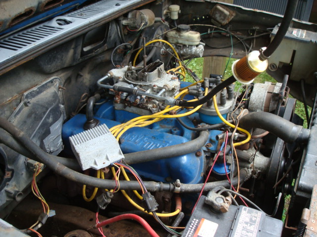

heres the 302 i had in mt 83 ranger

This may be a stupid question but I was always told there is no such thing as a stupid question so here it goes. Which fuel line is the feed? I imagine it was the bigger one and the smaller one was the return. The black one is just a vapor return from what I understand. I don't have emissions so can I get rid of that and the charcoal canister? If not where must the hose from the canisiter go? I won't be needing the return line anymore so should I plug the line or put a breather type filter on the end?
Re: 5.0 Install
the bigger one is the feed
onewontwo
Posts: 277
Joined: Sat Sep 01, 2007 1:14 pm
Re: 5.0 Install
Post by onewontwo »
What would you do, plug the return?
Re: 5.0 Install
NO,that will give it to much presuure
onewontwo
Posts: 277
Re: 5.0 Install
Post by onewontwo »

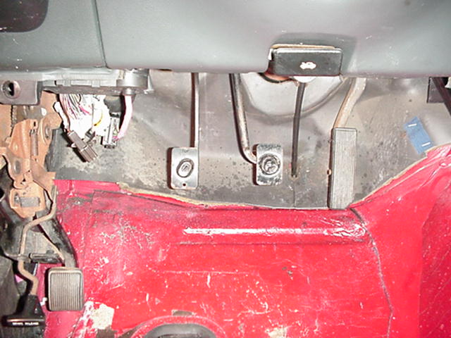

So I'll just put a breather type filter on the end. Here is another question for you, can I add a clutch to my brake assembly, or will I need a whole new one. If I need a new one I'll be making a custum one. I just want to find out before I start fabbing something.
Re: 5.0 Install
i think the(auto) brake pedal is to wide just to ad a clutch pedal. i think your gonna need both pedals. i swapped a navajo over to a 5spd. looks kike theres a enough room for the big brake pedal there
Re: 5.0 Install
nope,your gonna need both pedals. with the auto,the brake pedal has the piviot pin welded to it,with a std,the clutch pedal has the piviot welded to it and slides through the brake pedal. its all commin back to me now

Thanks. I'll make something up, and just put a limit switch in for safety.
