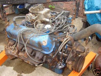

Alright. I'm going to find a different carb at the junkyard, but minus the linkage this carb I have is in good shape. It still sprays the gas and everything operates smoothly.. There is an injected crown vic with everything in tac. I'll possibly get that stuff for the future.

I'll get that turned around. I think one of the linkage arms is for cruise control which I don't want, need, or have. So if I can just get the throttle linkage figured out I would be set. The piece that the anchor bolt is on seems to have a broken stud. It kind of rotates and I think it shouldn't be doing that. I think it's a holley 2300. That's what I came up with.

It is LIST 6433. I googled it and came up with very little info. I saw one source saying it was a model 2300. I'm not sure how reliable it was.

Well I can't rotate the bottom plate. The throttle won't open up then. I would have to rotate the entire carb but that wouldn't be right. I found a broken pin on the throttle stop which caused it to rotate. The throttle stop was not adjusted right causing it to make the choke plate stick open. And I think I have 2 brackets in the throttle linkage because one is for cruise control. Everything should be good with this carb. Really the only thing it needs is my throttle cable. :cool:

in the pic above, the spacer sets in the intake as pictured. i have never seen one turned around. even the 4V ones are the PCV is in the back

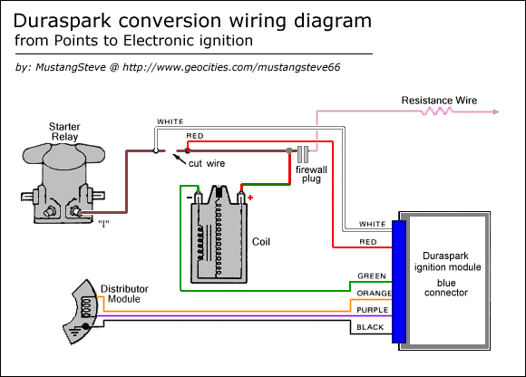

Yeah, I don't know. I turned it as you said and it won't work that way. Do you have any wiring diagrams or know how to splice it into my '88? It is the blue grommet ignition, however I'm not sure if it's the I or II.
Re: 5.0 Install
in the back. the pickup in the dist has to be blue also

The pick up in the distributor? Well I pulled it out of the same vehicle so hopefully it's right. Can you tell if I have the I or II?
Re: 5.0 Install
the 1 had the small cap i think and the 2 has a two piece cap

Alright I got the II then. From what I've read the blue grommet is the best. So that's good.
