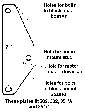

- wanting to try these motor mount adapters, or should I just buy some motor mounts??

bartmantom,
Like Ranger 5.0 said, you need a bit more info to build that part.
Now don't take this wrong but you need to furnish the info a builder needs to construct your part. I am going to list just a few things here.
1# there are very few dimensions shown.
2# what are the hole diameters?
3# the 7in dimension, as shown on the print indicates 7in to the edge of the hole. Is it really to the edge or is it 7in from center to center?
4# what are the rest of the dimensions?
5# is this just a piece of (insert thickness here) flat plate or are there other bends and such?
6# what are the dotted lines showing?
As I said I am not trying to rant just trying to help ya along. As a fabricator if you came into my shop and showed me that drawing and asked me to build it I would quote you something like 500 bucks for making a 1 off part. The real cost is for me to figure out all of your missing info. If I built the part guessing what the numbers are and quoted ya 20 bucks. You would be back camped on my door after trying to install it telling me it didn't fit and then wasting hours of my time trying to get it to fit!
So go measure the dimensions post them here and I bet someone (maybe even myself) might be able to whip up a set for you.
So there ya go I really hope this info helps ya out.

That picture is a generic one that has been around a long time to use 2.9L motor mounts with a v8. The missing info is due to this being a piece that you have to make and customize to your specific situation (at least thats how it was described to me). The single hole and dowel hole were to be cut out after the plate was bolted to the v8 and dropped to the already mounted (to the frame) motor mounts. Then mark and drill as needed.
If there is someone here that has made the mounts before and can measure all that is required, then making a set would be much faster im guessing.

when i did mine
i made the plates as pictured(without the stud hole) and bolted it to the block.Mine was a 4cyl truck so i used those mounts.Put the engine and trans(C5) in and bolted the trans to the crossmember in the original location.I put some grease on the motor mount stud and lowered the engine down so it put a grease make on the adapter plate.Pick the engine up a little,take the plate off and drill where the grease spot is.Out the plate back on and lower the engine down, DONE

when i did mine
i made the plates as pictured(without the stud hole) and bolted it to the block.Mine was a 4cyl truck so i used those mounts.Put the engine and trans(C5) in and bolted the trans to the crossmember in the original location.I put some grease on the motor mount stud and lowered the engine down so it put a grease make on the adapter plate.Pick the engine up a little,take the plate off and drill where the grease spot is.Out the plate back on and lower the engine down, DONE.And theres plenty of room for exh.

I have read that motor mounts off of early 70's ford vans work. I have the motor mount but have not tried it out yet. They have a stud coming out the bottom to drop into the existing motor mount hole.

I made a set like that. First I made a set that had slots front to rear for the stud and dowel so I could adjust the engine's position, then I marked where in the slot it was and lifted the motor up took off the plates and used them as templates to make one like what you have pictured. They are actually really simply to make. I used a metal cutting wheel on a table saw and a few drill bits, you could do it with an angle or die grinder too though. If you don't have those simple tools or know some one who does this is going to be a big project to tackle.
