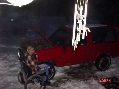

hey I have some pics of my truck with a 3" trailmaster body lift and 31's on the stock rims if ya want to take a loot http://www.cardomain.com/memberpage/372896

Hey Wackston,
Black ice? That sucks 'bro, nice lookin truck.
