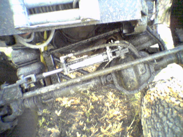

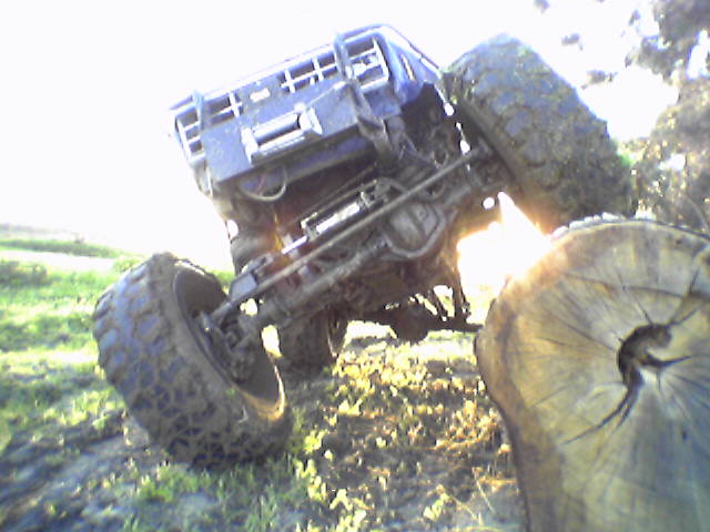

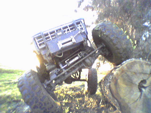

well i finaly got the full hydro setup and air bags done. So i went out and played in the mud a little bit and then climbed up some stumps and rocks.

how much flex did you gain in the front?
it looks like you got more out of the coils...maybe it is just the angles I am seeing the truck from.
I lost some flex but the truck is way way more stable! i used to be able to push the truck from side to side and almost tauch my tires to the finder now i cant even budge the truck and i dont feel so fat when i get in (the truck doesnt learch to my side) It also flexs pretty good so far. it will compress all the way down and there is still some more drop but i have to out better limiting straps on there so i can get the drop setup to the right hight. The bags have 8 inches of travel.

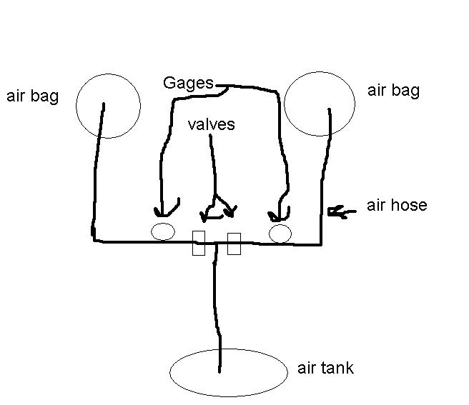

how do you limit the bags from going to low or over full? do you have individual controls for each wheel or do you allow air to float inbetween the bags?
I have been looking at this setup, but the controls have still not realy been explained well.
you dont limit the bags from to low of pressure or over filling they are just like your tires you put a certain PSI in them when your on level ground and you run around with them like that. If i like them i will plumb them up so i can push more air in one bag and drop the air in another with gadges on each side. this will give me alot of control over the truck. I need to limit the downward travel on the suspension because if i dont the bags will pull apart. the bags have built in bump stops so i dont have to put any of those. Hope this dieagrame helps you under stand what i was think.
so every time you go over something you have to adjust the suspension to flex?
nope it runs like normal coils but you can change the rate of the spring. Its like having the abblitlty to change you coils from soft to stiff in a second! you can also push one side up to keep the truck level.
