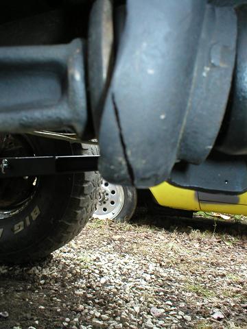

got the shims on and the springs are strait......next question, here is a pic of the radius arm brackets:
the retainer is kinda close so I was thinking to trim the bottom of the bracket here:
I am thinking if I trim it and run the offset bushings it will complete the fix. what do y'all think? I am realy worried about the bracket becomming weaker and bending.......

I think you would be fine shaving the bracket where you have it marked, it wouldn't weaken it that much. It is made for a 5000 lb truck and you are using it on a much lighter one anyways.
