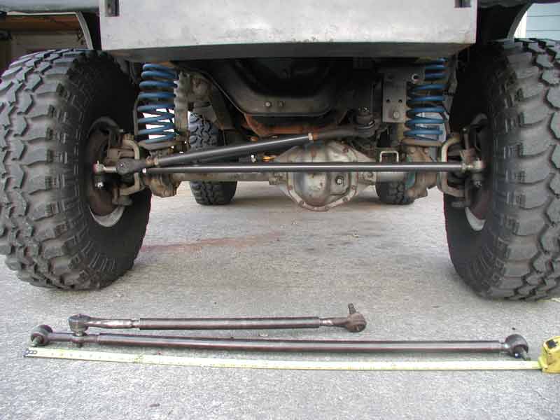

I want my steering to look like this, right now the tie rod ends are on the bottom of the same mounting location.

I realy wanted to use the stock stuff I have now. wasn't trying to swap everything out,what I am afraid of is having a whole that looks like this:
instead of this:
I think if I swap over to the chevy TRE's it will look more like the second one, but then I am getting into more then I wanted to.
