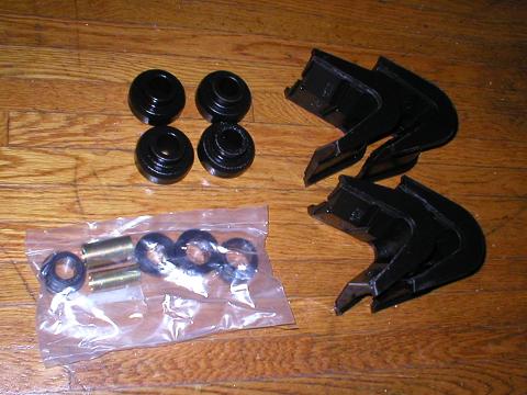

well, I got my bushings today

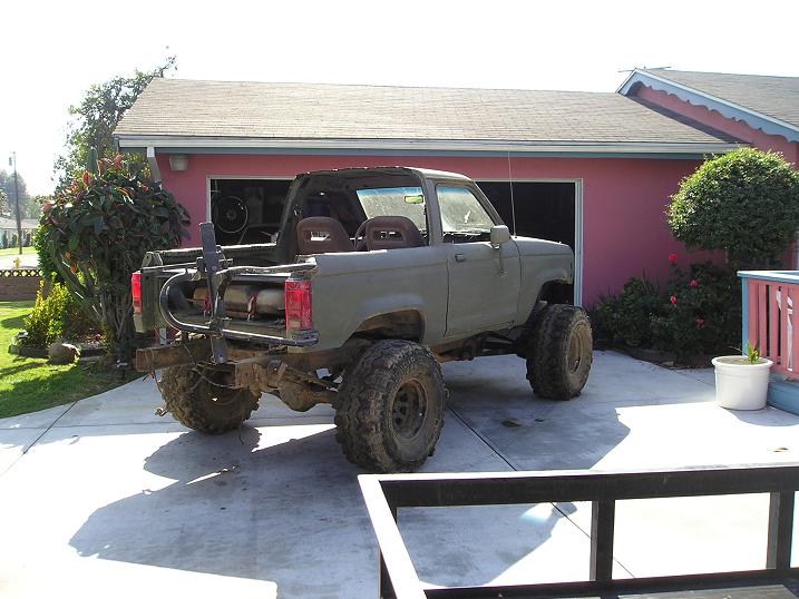

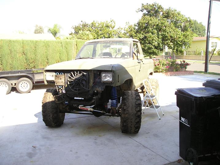

yep sit's about 1 1/2" lower. the rear need's to be raised about 1-2" so i will be figuring out a new plan of attack for the rear. not much of a body lift the lift is mostly were it count's under the front clip and the rear bed. the center section is about 1" abouve the frame on my rig. i was thinking the same with chopping the finder's i geuss it's a sawsall for christmas.Nobody Posted: Tue Nov 02, 2004 6:46 am Post subject:
So it's a little lower than it was?
I think it has a pretty good stance now, but a lot of that is built in body lift. Chop some fender and you're set. You still need to work on the rear right?
I'm curious, take a measurement from the lowest point of the frame to the ground, under the drivers door. Also, the width of the frame, outside to outside, from under the drivers door to pass door.
thank's fellas you'll probabaly want to upgrade tp 35 phillippi.
Dbrown i have'nt flexed it yet i just had enough time to install the coil's, flex fan and put tires back on to make sure it cleared the garage. the superflex coil's are suppose to be really good so i've heard but i dont think there progressive and there some thing like 26" unsprung for 4" lift coil's to tall for me.
