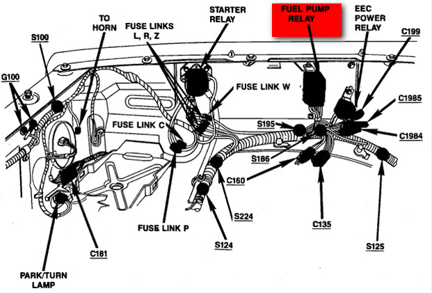

Anyone know exactly where the EEC power relay is located?

Sein Hows Nobody else is gonna answer this question I will venture a drawing to help you out. Here you go!!!!!!
