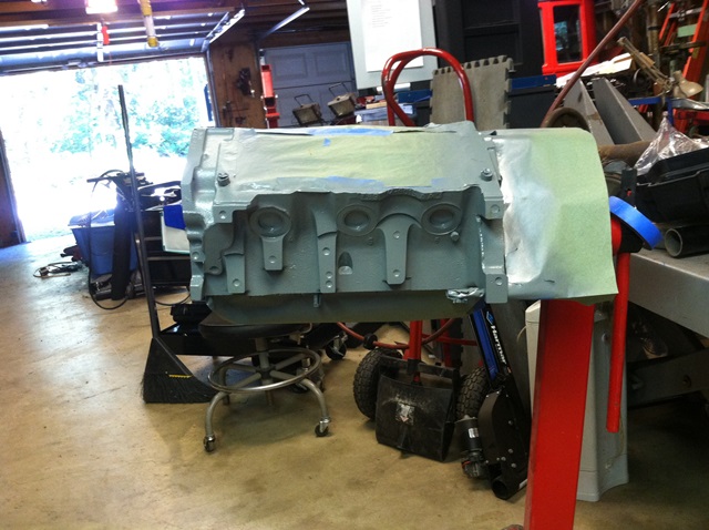

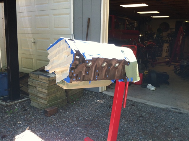

The Block has been washed and cleaned and yesterday I masked everything off and Shot a couple of coats of VHT Ford Grey on it and today I plan on starting on the glyptal coating and hope to finish that before the weekend is over.

Well here I am. Making slow but steady Progress. The block is done and ready for assembly. I have it wrapped up in a garbage bag to keep it clean till I finish all the grinding and sanding on the heads.
