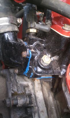

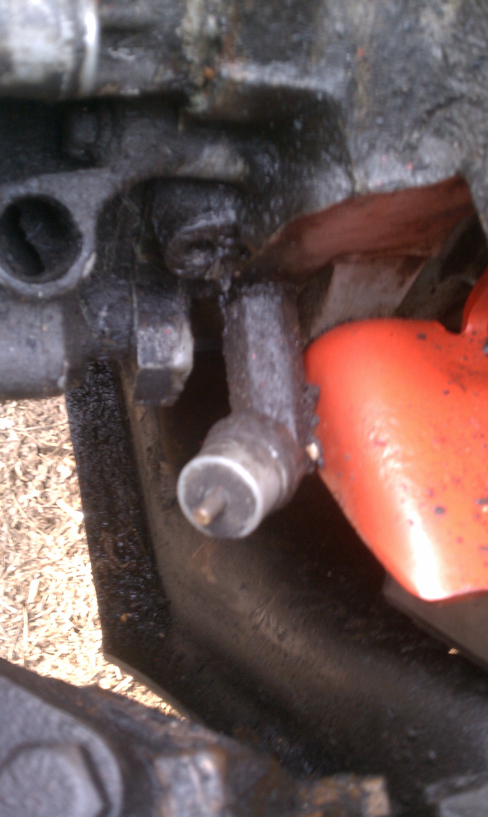

hi, i have an 87 bronco ii 2.9l v6 that i put a 2.9l v6 from a 90 ranger. i am left with these two sensors that have nothing to go to them. i was wondering if someone could identify the sensors and tell me what goes on them. One is right next to the thermostate and the other is next to the driver side engine mount. That would be a huge help. Thank you im awaiting your response.

top is oil pressure sender and the lower is temp sender. got to be some wire there somewhere. same place on B2's and Rangers

they will be single wires with a rubber elbow on the end that just push onto the sensor. they will come from the firewall in the main harness
