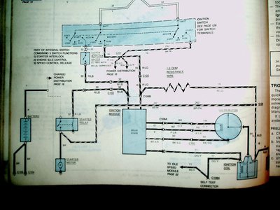

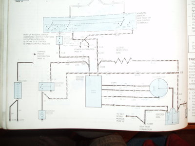

Things make a bit more sense. I am going to assume a couple of things and if you know different let me know. 1985 B2 I assume it is 2.8L with duraspark. If we are talking about different configuration then let me know.
I took the schematic posted above and tried to enhance it some so you could read it easier.
Now here is where I take another wild swing at this thing. If we are talking about this schematic in the beginning My first gut feeling says your original problem is most likely the Sensor or "Pickup" inside the distributor. When it is cold it works when it gets warm it quits. You really only have 2 things that are typical failures in a duraspark ignition and that is the little duraspark module,box,whatever ya want to call it and the sensor inside the distributor. The sensor is subject to a crap load of heat and I have seen more sensors replaced than duraspark modules. Now on to the coil. The low side goes to the duraspark module and the + side goes to the ballast resistor. I am real unsure what could burn your coil and ballast resistor up except a dead short at the - side of the coil and the ignition was left on for a long length of time. It is possible to have a problem in the duraspark that is loading the coil but I really don't think so.
Let me ask you a couple more questions. Why did the first coil get replaced? I am thinking it is possible you got the wrong replacement coil. That is a possibility. Also does it start and run now till it warms up?
Think about what I have said and let me know the answers to my questions.
