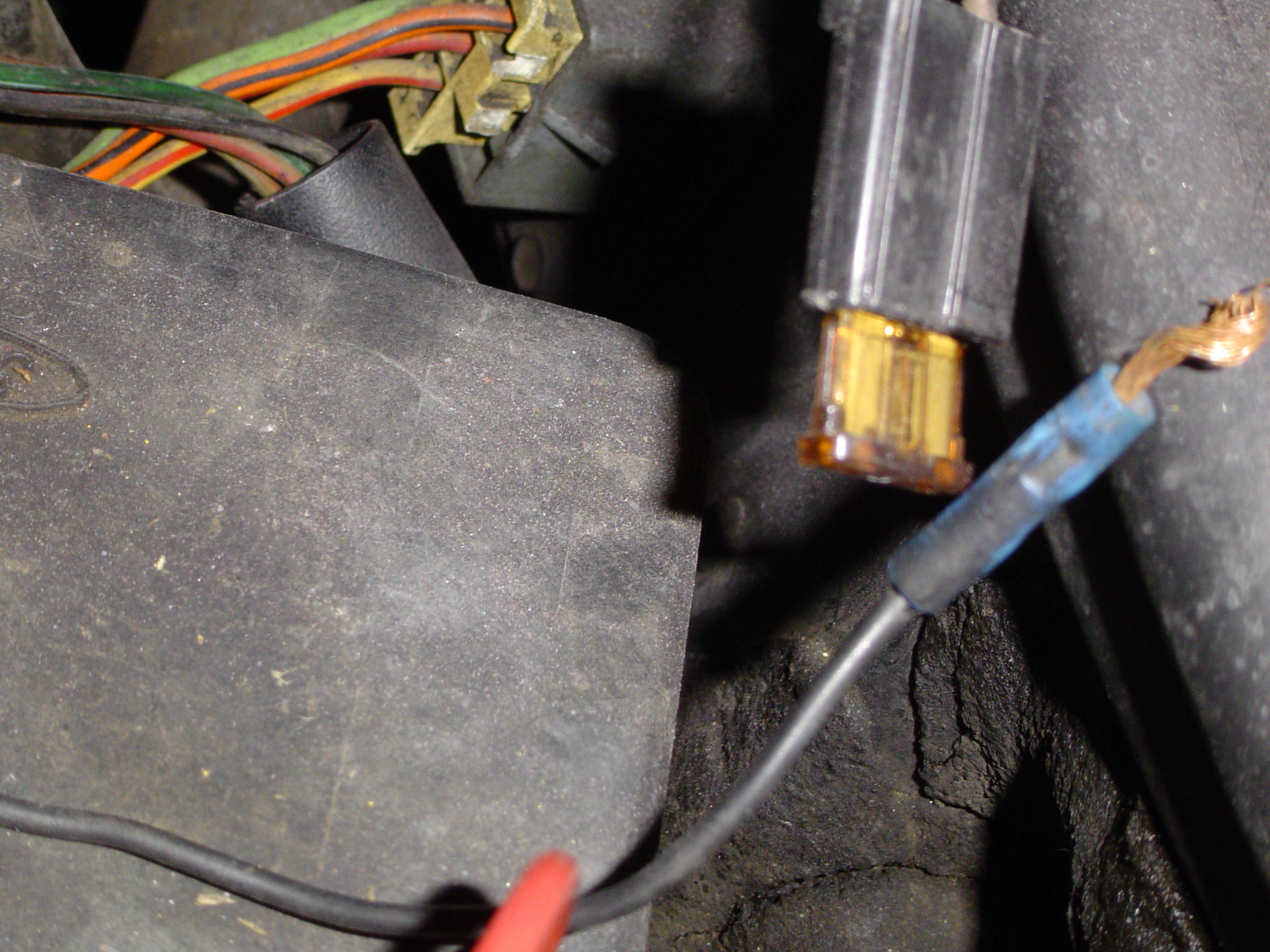

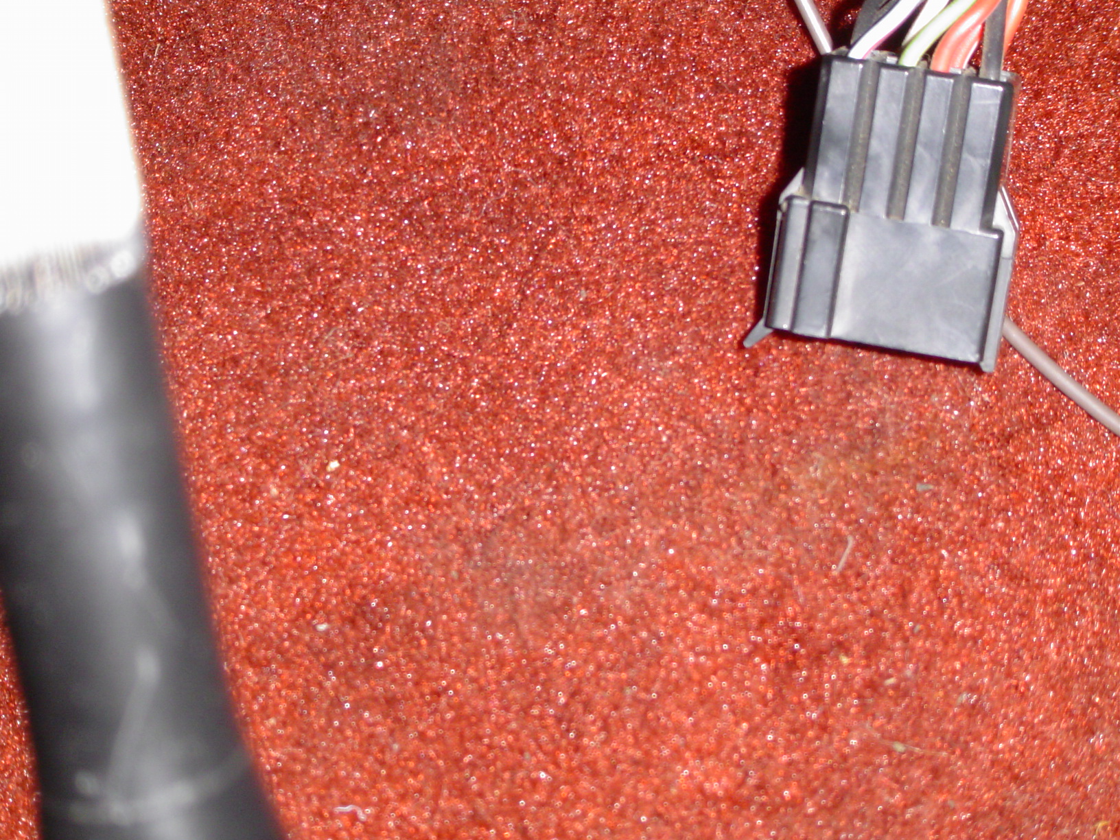

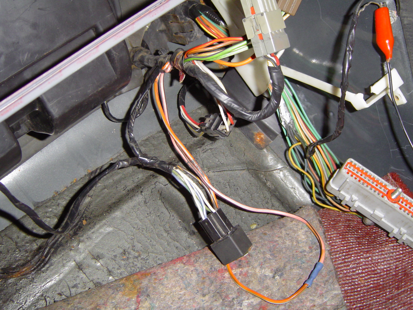

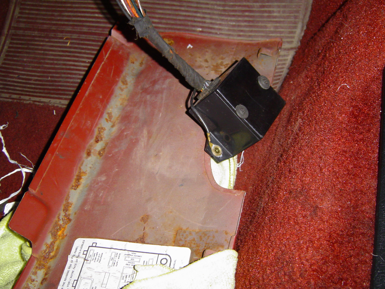

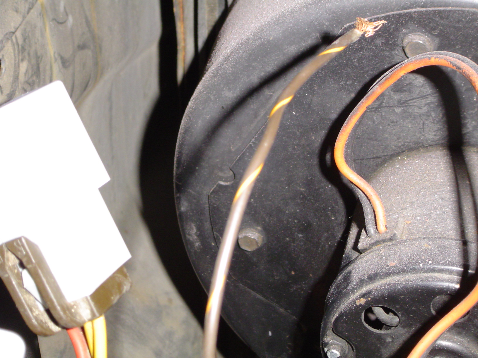

This is a 1986 with the 2.9 V6. Looks like it has had some recent work on the engine but the electrical sucks. Attached are some of my problems. I do have a re-manufactured computer but it is not installed yet until I get the electrical fixed. I have also replaced the fuel relay and the EEC relay.

A little help out there. As you can see from the pictures, this is all I have left to fix befor putting the computer in. After that, it will get a paint job and brakes and shocks and will be ready for both worlds. I would like to get this done. I just don't know what those wires go to and what plugs into the plug hanging down. Any ideas?

have you thought of going to a junkyard and see if you can figure where they go? basket cases are always a pain cause it looks like there are a lot of cut wires
