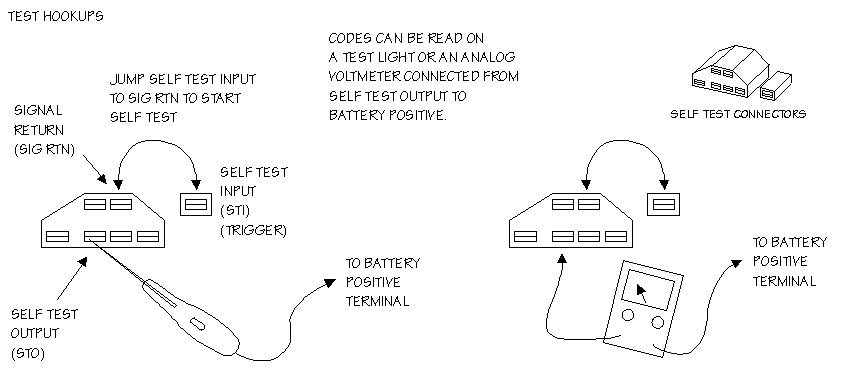

That is good info, but which 2 leads do you hook up? And if you hook up the wrong ones, will it hurt the ECM?
Thanks.

RakerBill60 wrote:That is good info, but which 2 leads do you hook up? And if you hook up the wrong ones, will it hurt the ECM?
Thanks.
No damage to the ECM and heres a pic
test hookups.gif (13.45 KiB) Viewed 8625 times

Awesome. Will it work if there is no check engine or Emission light on? I want to know what my engine parameters are to see if the fuel pressure and relevant emissions are in order. I am contemplating buying an OBD1 tester, if'n I can find one.
Thanks for the reply, it helps a lot.
