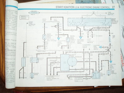

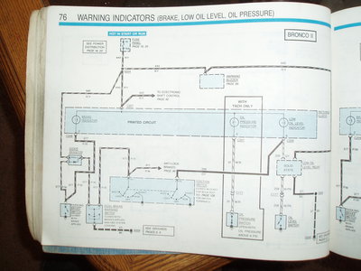

Re: tachometer
I've done it on other Ford products, not a BII and it was just a plug in. You may have to change the oil presser sender as it will be a light instead of gauge type. The schematic I included is for a 88. 89 will be different

Re: tachometer
The instrument panel with the tach will not work with the non-tach wiring. The right-side wiring works but the left-side is totally differant. I followed the wiring and its not much to change but it does need to be changed. I looked at the local boneyard and could easily see as it was stripped out and showed where the wires went.

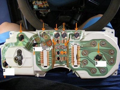

Re: tachometer
I just took out my Cluster out to change to LED lights (works bitch’n) Wished I took a picture of the back of my Cluster but if you look at the picture below #3 (non-tach) that’s the side of the Tach. If the Tach side connector loom wiring has wires in the void (right side of picture connector with only 5 connections to the circuit board ribbon) then it should work. If the loom doesn’t, then I’m wrong and wouldn’t be the first time I have been. On another note, the LED lights really brighten up the dash lights for these almost 50 year old eyes. I got them in blue and they look cool. I got them from http://www.superbrightleds.com and the part # is WLED-X6 and you’ll need 3 for non-tach and 4 for tach. Again, sorry if I misled anyone if I was wrong.

I know it's off subjust but if you put in the LED's you have to take out the green covers inside the Cluster. That means taking out the gauges and be careful with the needles cause they're brittle. Found out the hard way and had to make a new one.

Re: tachometer
The plastic connector on the wire is differant and prevents them from connecting with non-compatable clusters.drofman wrote:I just took out my Cluster out to change to LED lights (works bitch’n) Wished I took a picture of the back of my Cluster but if you look at the picture below #3 (non-tach) that’s the side of the Tach. If the Tach side connector loom wiring has wires in the void (right side of picture connector with only 5 connections to the circuit board ribbon) then it should work. If the loom doesn’t, then I’m wrong and wouldn’t be the first time I have been. On another note, the LED lights really brighten up the dash lights for these almost 50 year old eyes. I got them in blue and they look cool. I got them from http://www.superbrightleds.com and the part # is WLED-X6 and you’ll need 3 for non-tach and 4 for tach. Again, sorry if I misled anyone if I was wrong.
