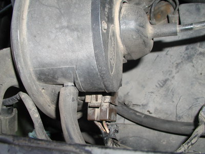

Re: 1986 Bronco II, speed control
Sorry I forgot to say where didn’t I. At the controller. Under the hood, on the driver side of the vacuum canister. as seen in the picture.
