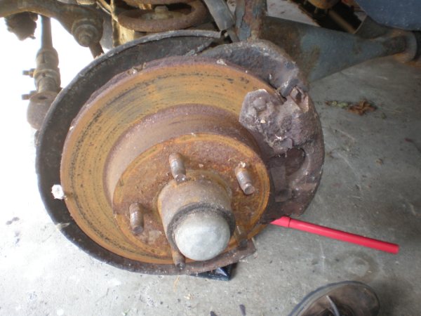

here are pics when i got the wheels off. What should i replace and what can i clean up?
						Re: 88 bronco 2 brakes help
2wd?  Those are rare around here.  Anyway I would start with rotors, pads and new rubber lines.  I would also clean up those calipers as good as you can.  I would assume that the drums look the same.  I am guessing that they would also need replacing as well as the pads, cylinder and ruber line as well.
When I got my BII, I had to replace all the brakes. I had to put on new rotors($40 each from advanced) becuz one had a crack in it and u have to replace both sides at the same time. I put new pads on it($20 for both sides from advanced auto) I ended up having t replace the calipers too, they were shot and the pistons weren't going back in no matter what I did( I think they were 20 or 40 each but there was a 10 dollar core charge). I replaced the shoes on the rear (20 for both sides) A piston on one side ($15) and some little cable thing ($3) I also replaced both rear lines($3 forma local cheap store) but I had to get adaptors from an auto part store for them to fit ($5 each) I also flushed all my lines. So now my brakes are good. My rotors and calipers looked just like yours is the point of my post. I should have just said replace them, haha.
+1 for tekatlarge
Brake inspection and replacement of all the parts that even look suspicious is imperative.
From what I saw in the pictures, I would replace everything from the steel brake lines on the spring buckets out.
The parts are not that expensive and will save lives.
Yep sure do. I live in michigan. Just a quick question. How do i remove the rotors. Gotten as far as removing the calipers. Also what would you guys recommend cleaning it up with? When i did my bike brakes i used simple green.
found calipers at advanceauto for 16.99 (10 core), rotors online for 20 each and brake lines for 17 each. still gotta do the rear drums.
