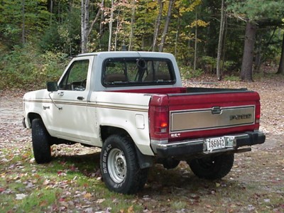

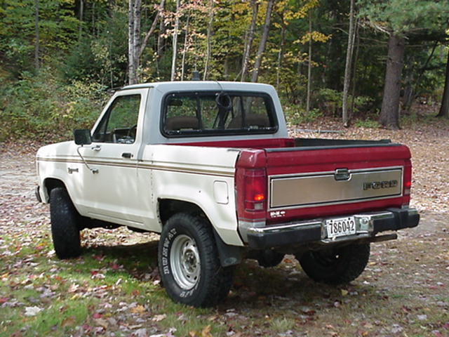

'88 Bronco II, Stock front end.

My 88 B2. all the ones ive seen do it
