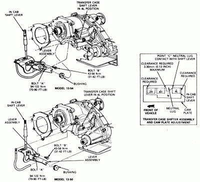

The car's in great shape, interior and exterior, although I have an issue with the transfer case... it won't stay in 4WD high and keeps bouncing back to normal. A Ford guy told me there was a detent ball in the transfer case that holds the shift mechanism. I don't want to dismantle it all... is there anything I can drip or spray in there that would make the ball pop to life???

i run Rancho 5000 in my B2 and xplorer. as far as the springs go, is it saggin?? post a pic of it. there is a adjustment on the t-case shifter bracket where it bolts to the t-case, try to adjust it. leaky front seal in the engine??

Hate to sound stupid here (I'm a expert in the 3 series BMW 84-91, but that doesn't help me much with the Bronco II) but you mention an adjustment on the t-case shifter. How do I acess that? Do I go under the vehicle or get to it from inside the car?

its bolt "B" and you get at it from underneath. 91 ta 94 xplorer springs bolt in. get the 4dr ones http://rangerdave.freeforums.org/post1262.html#p1262
