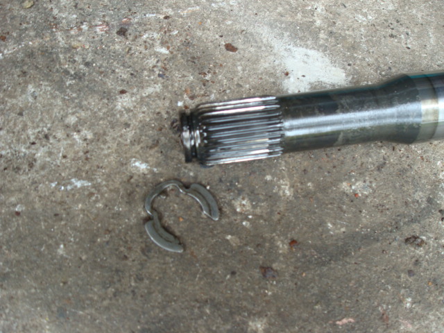

The passenger side is the one with the c-clip on the shaft. The drivers side (short side) should come out freely when the spindle is off. Are you sure you got the short shaft that is c-clipped into the diff and not just pulled the slip shaft apart?

as stated above, the pass side has the C clip in the diff. the drivers side comes right out

I'm assuming that to pull the c-clip off the passenger side shaft, I'll have to actually unbolt and drop the front differential, so as to gain access.
My Haynes manual does not show anything about the front differential parts, clips, bearings, etc. Does the c-clip come out similar to the rear shaft/diff c-clips?

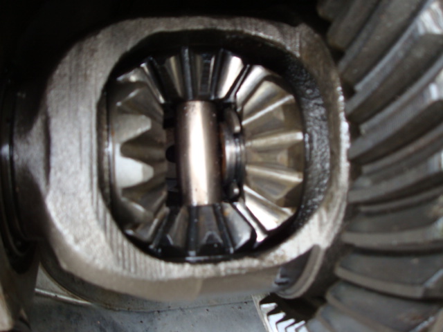

the C clip comes out just the rears do. theres a rool pin ya need to punch to one side to get the center pin out

There's no need to remove the coil spring or radius arm to drop the front diff, right? My Haynes says something about pulling the coil spring. Doesn't seem necessary to me.

Re: Pulling front drive shafts, 89bII 4x4
Thanks for the pics. You make it look easy....
