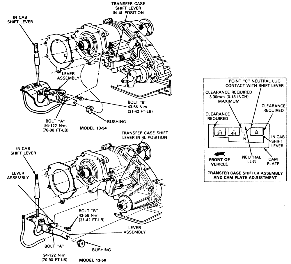

I had something similiar about 7 yrs ago and the fix was to access the top of the transfer case and loosen the bolt that allows the movement of the shifter IIRC. Loosen the bolt and check for the movement needed to fully engage into 4x4. Anyone please correct me if I am wrong. If I still had my stock engine/tranny I would go out and look.

you can adjust the shifter by losening BOLT "B"
