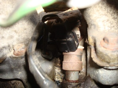

no not yet i cant seem to get the injector plug off the injector

apperently the 2.9 that i rebuilt musta had a after market connecters on it cause it had the wire clips
my 2.9 doesnt have um
- Posts: 1435
Re: PLEASE HELP!?!?!?!?!?!
you will most likely break those tabs off.thats probably what happened to the one i rebuilt.
ok so i got the injector cap off and there isnt any pulse when i try to start it, and apparently i grounded something out i wasnt supposed to because now when i try to start it i just get a click out of the starter relay, what could that be?
