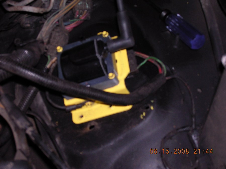

Got the little thing running perfect. I wanted to match the other components in the engine bay, so I took off the coil a painted to match. I made sure all wire connection where clean of paint, put it back on and no spark now. Bought a new coil, still no spark. Any ideas. :confused:

you painted the bracket which provides a nessary ground, stip paint at all mounting holes

All ready did.

Check to see that all your connections are sound and that it's getting good ground.
