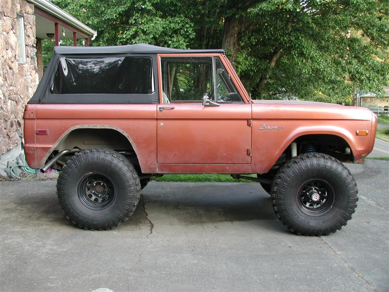

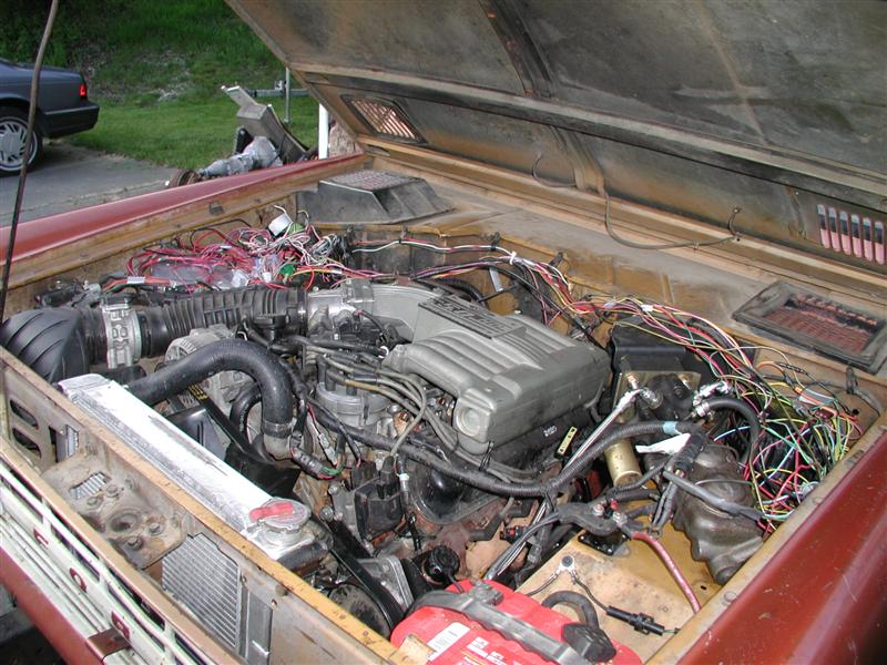

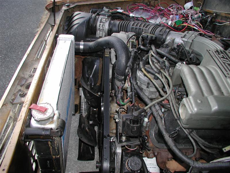

Spent last weekend on the wiring. Finished up a few loose ends tonight, checked codes. Put in some gas and started it up first try! Whooo hooo! :cool: :cool:
This has been one long project. Still have quite a few loose ends to clean up, but the hardest part is done.

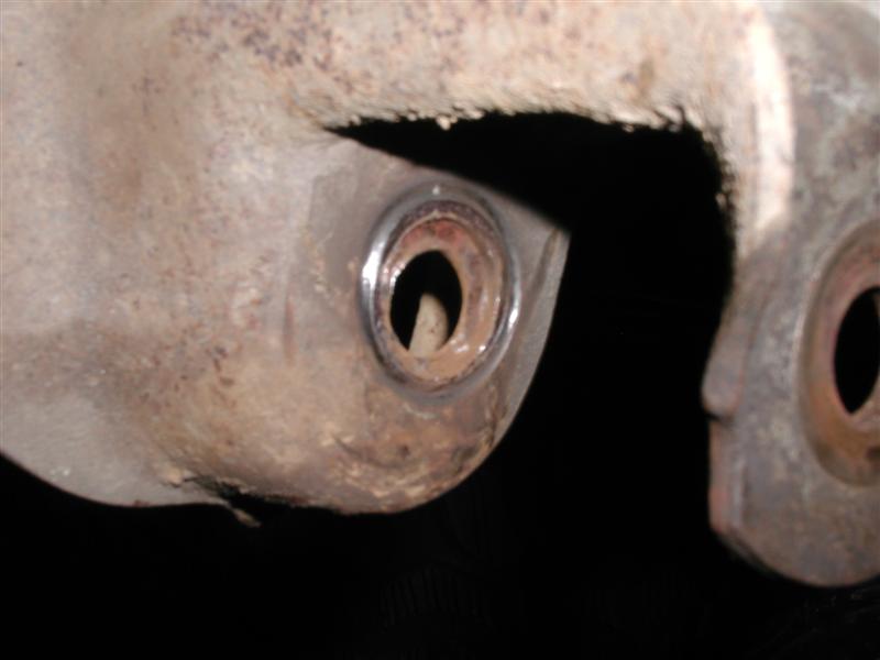

Finally feels like I'm making some progress. Got the 9" pulled out, the Dana 60 stripped of the old perches and shock mounts. Need to do some spring hander repair before I can start assembly. Still need to do the final wiring, put everthing in place and cut resolder and wrap wires. Still lots of little stuff like fender flares, battery box, bumpers, OBA, etc. But those are more resonable weekend projects.
I got about 50 miles on it before I yanked the 9 inch. The 9 has 4.10's, and even with 36's it hauls ass! Definately want the 4.56's though. I'm not to happy with the exhaust. It's a little louder than I wanted, but that's what I get for now.

Used the stock T-bird throttle cable. Modified the EB gas peddle to work with it.

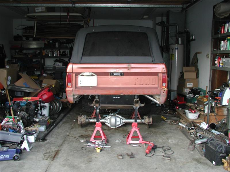

I've got the D60 pretty much in. Just need to set the pinion angle and weld up the perches. Ran into a bit of a snag with the shocks. The rear disc calipers are in the way of the stock mounts, so I need to build new mounts to put the shocks in front of the axle.
