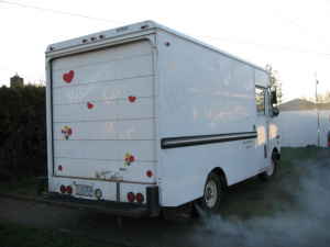

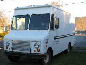

Post by bartmantom »
this is the donor vehicle.

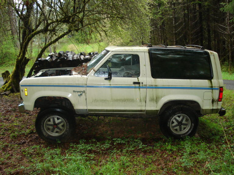

here is a pic of the bronco, it was free to me when my buddy blew up the 2.9 litre V6. it's been sitting a long time waiting for a little love.

Nice greenery shot. Even on the BII

well, the BII has been sittin there over two years, so a little greenery isn't soo bad :redneck:

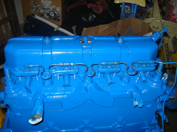

Re: 1987 diesel Bronco II

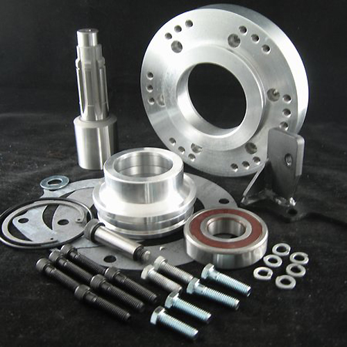

Motor's complete now, doing some clean up and paint then I'll get pics and post them. Going with the ZF 5 speed and the Dana 20, so needed an adapter. Ordered the transfer case adapter from Advanced Adapters the other day. here is the stock photo from the web site of the adapter kit.

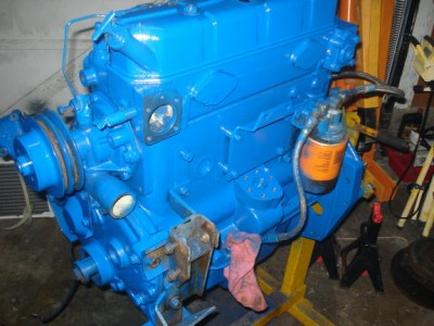

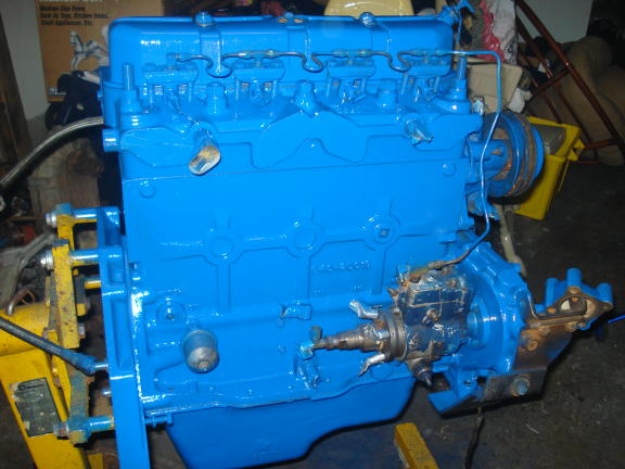

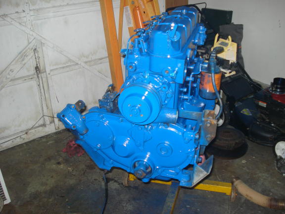

pretty much finished with putting the motor together, painted it tonight.

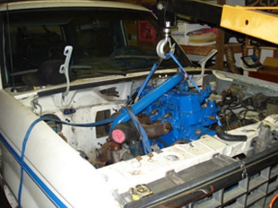

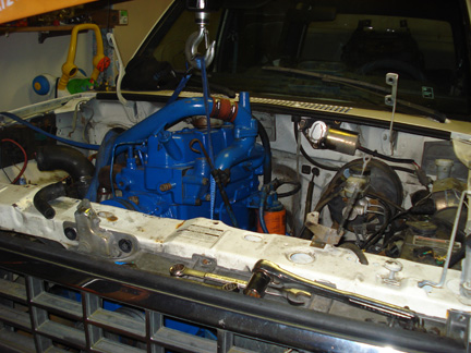

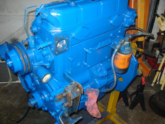

quick update and pics
put the motor in for the first time last night, taking measurements and getting ready to make the motor mounts.
on a side note, gonna need a hood scoop!! that dang diesel is tall!! the oil pan has about an inch to go before it hits the cross member and the top of the motor is about 2-3 inches above where the hood goes.
