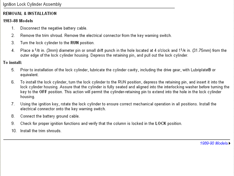

no key and is in off position how do i take the old one out without key or do i need one
Well since the the ignition cylinder is damaged, you might to drill it out or something....otherwise, here are the instructions in Chiltons.
