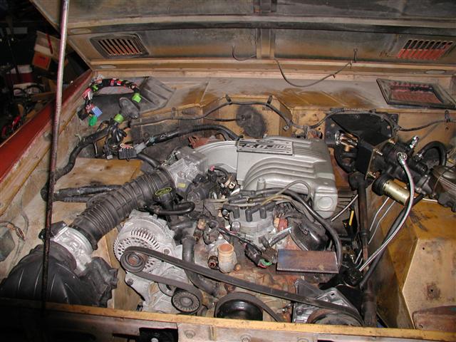

looks like you are moving along! how well did the NP435 shifter fit?
Posts: 992
Post by tekatlarge »
Hey that Looks GOOD man.. I like professional workmanship!
BTW what size and type of tire is that front tire on your bronco? :hmmm:
DBrown wrote:looks like you are moving along! how well did the NP435 shifter fit?
With the 2" body lift, it fit perfect. My hole was a little off though since the tranny isn't centered on the tunnel. I don't think I can remove the tranny without removing the engine at the same time. I'd have to cut the hole bigger to be able to slide the tranny back. It was a real SOB going in with just one person. Mostly because of the small hole.
I'm not quite done reshaping the shifter. It still hits the twin sticks a bit in 2nd gear. Might just chop down or ben the twin sticks instead.

I have always heard that you had to hack a big hole in the pan to get it to fit but that actualy looks better then I thought it would.
so did the np435 bolt to the original cross member?
I already had the AA NP435 adapter on my Bronco II. So yes it uses the factory crossmember. I also purchased the heavy duty motor mounts on a mass buy last summer.

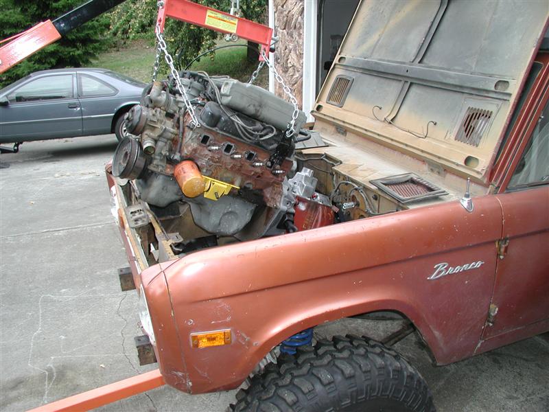

I reassembled the wiring harness in the driveway today. I took 99% of the wiring from the car. about the only thing cut was the stuff going into the doors. I still might pull the keyless entry touch pad. Seems like it might be usefull for something someday.
The Donor:
1992 Thunderbird
5.0L HO
99,000 miles
