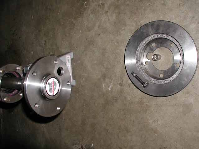

ok guys im at my wits end trying to figure out what rotors will work on my 9 inch.ive tryed all ford i think and jeep. my problem is that i cant find a rotor with an inside dia. of 7 inches which is what my axle flange is. i tryed putting them on the inside but then you cant access the 4 axle bolts. what do I do?
Put it on behind the axle flange. All you have to do is grind out a notch on the rotor so you can access the bolts.

i knew i was being an idiot! dude your awesome thanks! back out to the shop i go!
