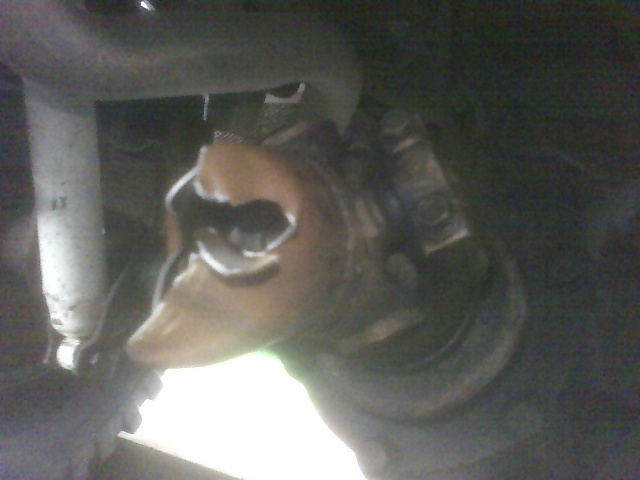

QUESTION: on the james duff website, it specifies two dshafts, short and long, but only for 86 - 89. i have a 90, manual trans, do i need the short or the long? I don't know which i need. in the picture posted on page 1 of this thread, by mr. hair, is the top one, the double cardan the short one, and the lower on, the single cardan, the longer one? i am unlifted at this point, but need a shaft now. does anyone know if i need a short or a long? or even how long each of them are, because i could go and measure mine to compare. I just don't want to get the wrong one.
I went into my NAPA a while ago, and explained the scenario. I gave them those part numbers, listed with mr. hair's post, and they said that an american napa part # is no good, and all they can order is the same crappy tulip style shaft. so i thought, maybe if i order a different year?!?! does this sound good, and if so, what year? 88? 87? they indicated that they have no way of knowing what it looks like until they get it. what would you do?
Wow Canadans can't cross numbers? they use the same supplyers! could it be they are that lazy?BDEUCE wrote:QUESTION: on the james duff website, it specifies two dshafts, short and long, but only for 86 - 89. i have a 90, manual trans, do i need the short or the long? I don't know which i need. in the picture posted on page 1 of this thread, by mr. hair, is the top one, the double cardan the short one, and the lower on, the single cardan, the longer one? i am unlifted at this point, but need a shaft now. does anyone know if i need a short or a long? or even how long each of them are, because i could go and measure mine to compare. I just don't want to get the wrong one.
use the 88 and later
87 and earlier short trans long driveshaft
88 and latter long trans and short driveshaft

okay, so i've decided to go the route of getting a sploder shaft, and having it cut & balanced. the guy at the yard screwed me up by not knowing what i'm doing.  (it's not a u-pick yard. his mechanics actually get the parts for you)
I called him, but i realized i didn't know these things off the top of my head!! I felt like such a tool! then my guy at napa told me a place in alberta had one, short or long, he said short, it is 31" long. no measure on long one
Questions PLEASE!!!
90 Bronco II XL 5speed saggy springs tulip driveshaft with a length of 30 3/4" overall length, installed, outside face of flange to outside face of flange.
1, what age range of explorer
1.5, what model of sploder
2, do i need the front shaft, or the rear shaft.
3, do you think he'll know what double cardan means?
4, my d-shaft length is irrelevant to the guy at the yard, right? so what length approx would i need "from weld to weld, minus the length of how much the slip yoke is showing." ???
5, will this shaft come with both flanges, or will i need another flange from another driveshaft???
6, automatic, manual, and relevance?
