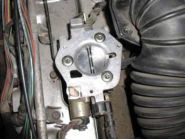

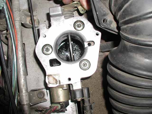

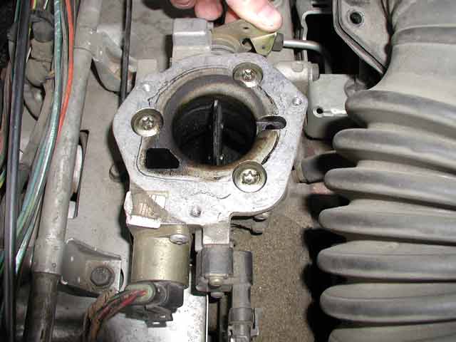

I didn't feel like pulling the throttle body off and cleaning it right, so I just went at with some carb cleaner and some rags. I even carefully used some steel wool on some stubborn spots, but don't tell anyone.

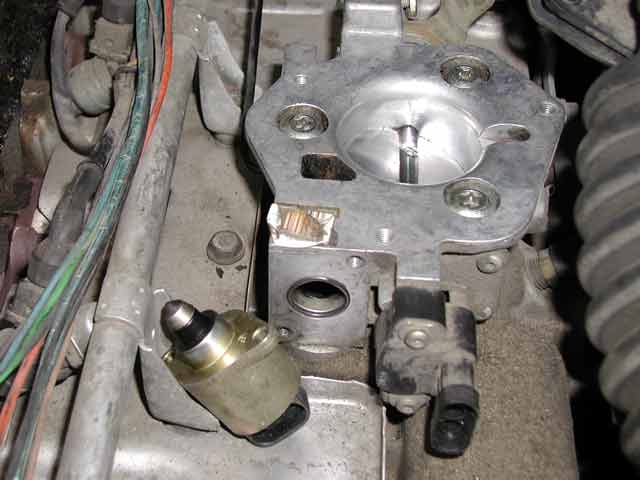

You'll also want to remove and clean the idle control solenoid. I cleaned mine about a month before and I didn't take a picture of how nasty it was. It was quite nasty. Make sure you clean inside the hole too.

I recommend removing the TB to clean it. Your engine wouldn't appreciate you dropping something down the intake, and you'll do a much better job.
