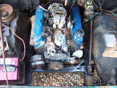

well, I got up early today to work on the EB and ended up just spinning in the mud.
started taking all the stuff off the BII to convert to duraspark, and get the electrical junk working. mounted most of it and figured out were I am going to wire everything in to make it look factory. robbed some of the brake fittings and got the brakes decent even though I have issues in the rear and have not even started on the disk conversion for the front. then started to clean all the serp and V pulleys which I now am thinking are junk because they set in the woods for too long and are kinda rotted in a few places.......
I just feel like I am moving no where.....
I figured y'all might want to see some progress pics so I got one for ya.

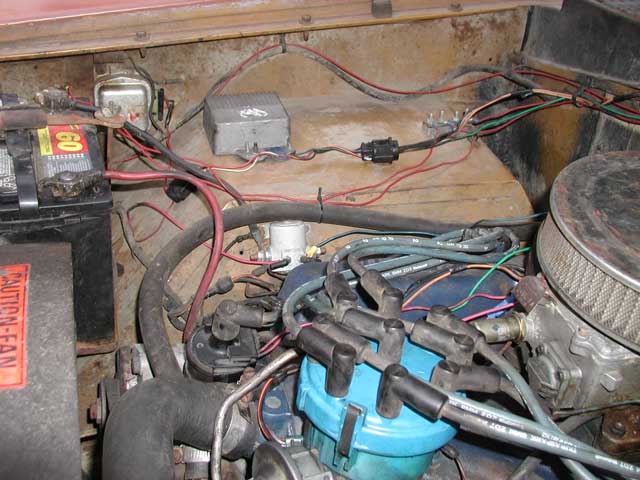

I did my duraspark conversion this weekend. Definately runs better. Very easy.
Yours appears to be duraspark I no duraspark II. You'll want to upgrade to duraspark II, as they have the large distributor cap and it's a better system.
Mount the module on the passenger side fender. Splice the run power into the green/red wire on the voltage regulator, and the start power to the S terminal of the starter solenoid. Use your existing coil power wire.
I also read that the later TFI coils are much better than the round canned coils. I'm going to switch, but I need a longer coil wire. I'm also doing gas mileage tests between changes.

The next time I go to the junk yard I'm going to pick the GM module and TFI coil. My Bronco II coil might be a TFI coil, I need to make sure.
The GM module gives a longer duration spark than the ford module, this also allows you to eliminate the resistor wire so you can put full power to the coil without burning it up. The TFI coils put out 1.5-2x more powerful spark.
For the high power spark, you'll need the large cap dizzy to prevent crossfire.
