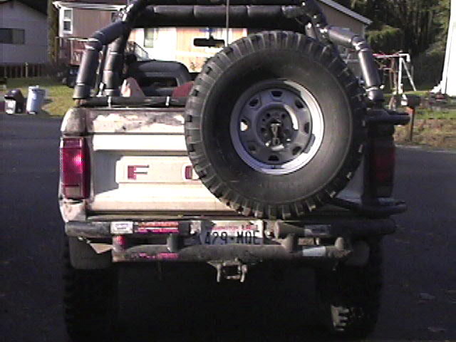

as far as the air filter I agree with keeping the box but have seen conical filters installed on the 2.9. As far as the cage they don't make a bolt in one and the pictures you showed were the worst example of a roll cage I have seen that is some thin tubing wrapped in padding, probably PVC insullation. I think you could add to the ranger one with good results though.

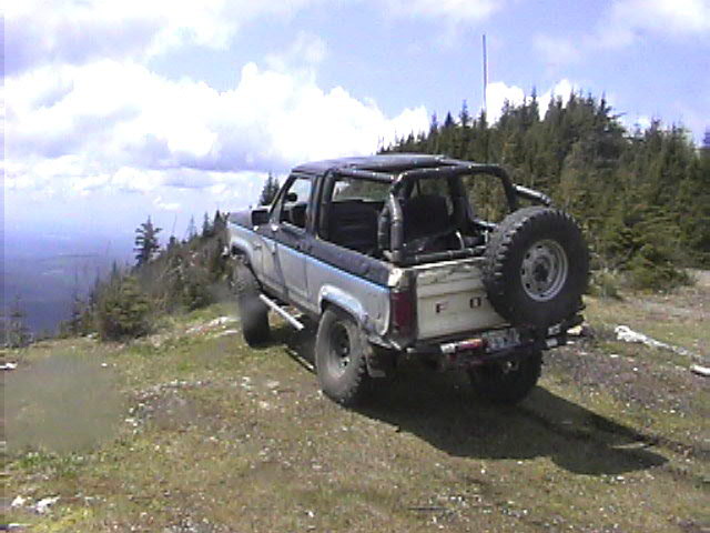

Sorry you didn't like the cage but I can assure you it is all roll cage material welded in. I used a combination of a cuple of cages that I had around and it did the job. I didn't have a large pocket to dig into and I did it all myself. It did structuraly enhance the chassis and was tested a few times with out failure.
