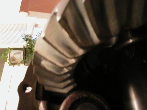

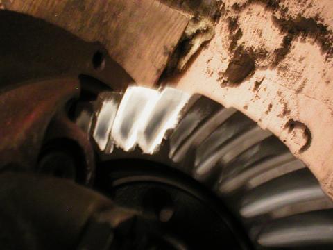

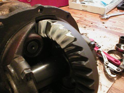

here you go:
gear install 026.jpg (21.44 KiB) Viewed 8293 times
I think it is close but what do y'all think?
I can't see the drive side very well. The coast side looks like the pinion is a too close.
What is your Backlash set at?
Add .006 to the pinion, set BL and see what it looks like.
Are you putting resistance on the ring gear and turning the pinion?

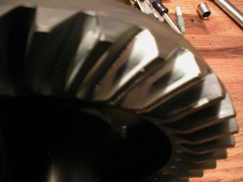

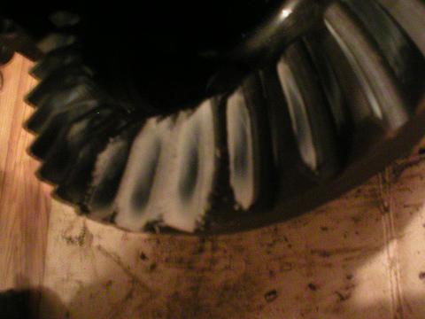

sorry it took so long to get back I was playing with the setup paint looking at how the pattern reacted to what I did. I think I got it better but the drive side is a little close to the center of the teeth the coast side looks like it is centered better though. let me know what you think.
this is what I have now:
gear install 004.jpg (21.88 KiB) Viewed 8272 times
gear install 003.jpg (22.73 KiB) Viewed 8272 times
my book says that is aacceptable......but I would still like some input. oh, and the back lash is 15 it is at the top of the tolerance but I heard it is better to have it on the loose end for offroad.
the wife is out of town so she has no idea :cool:
Tighten that Backlash up to the low end of the spec. Especially with new gears and bearings. I think that's part of the problem. I can't think of any reason to run at the top end of the spec. Personally I would want as little slop as possible.
I don't like how the coast side is down at the toe of the tooth. Tighten that backlash up and then lets have a look. I think the pinion is still too deep.
The drive side has some hard lines at the top and bottom. Don't like that either.

Try and get that coast side off the edge of the tooth.

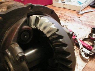

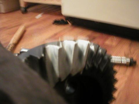

here is what I got now, I see what you mean about the crisp lines.
do you think it might have something to do with the fact they are so low(5.13's)? or should they set up nice and pretty like any other?
I read the paper wrong it needs to be 7-10 so I am at 9
gear install 006.jpg (23.52 KiB) Viewed 8254 times
gear install 005.jpg (29.15 KiB) Viewed 8254 times
Looking much better!
You could probably run that, but I'd tight that backlash up a little more. Those pictures aren't very good either!
edit:
Have you added any shims?Did you add the initial .006" I suggested? If so, you might add another .003"
accually added some and it got worse so I took some out just messing around and thats what I got, I have .021 in there now I had around .029 in there before. I didn't really like that the one side was at the center either but it looks like it is coming back to the center. I will try to tweak it some more......thanks for all the help so far :cool:
