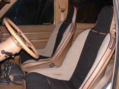

Well I FINALLY got my set of Mastercraft "Rubicon" seats.
Guess what?
Direct bolt-in! ('84 BII)
The left side runners I had to drill out the metric holes, for 3/8" bolts, but there SO close Im thinking you can run the bolts through with a wrench.
or 2 strokes with a round file. Its so close, that the right side needed nothing.
Pull the seats from the floor, pull the mounts from the old seats, bolt to the Mastercrafts, and then bolt them in!
1 hour MAX.
They also sit a little higher, but thats a welcome thing anyway.

Bob
Posts: 20
Joined: Sun Apr 18, 2004 10:22 pm
Location: Kingston, Wa
Post by Bob »
heres a couple pics...
The "Brown haze" color is a better match for real, but with the flash, and taking the pics in near dark...
I would have ordered the same colors if I had ordered them, but without the black, although with black harnesses, it will be fine...

Seats look good. Although bolting up to the stock holes won't help me much, as I plan to mount them to a cage.
I see the twin stick there. I assume you got your Dana 20 in. Did you ever get the driveline brake? Whose twin stick did you use? T-shift or J-shift?

no driveline brake...
Have added a steering brake, but it locked up the right side, and I had to send it back for a replacement.
The D20 is in, "J" shift
The twin stick I built.
Anyone who says the 1350 T-case will hold up to a V8 is right. Anyone who says the tranny output shaft into the 1350 will hold up...NOT
When I had the tranny out for a rebuild the output shaft was twisted aprox 1 spline. Sure glade I had all the D20 parts at the time!
With mounting your seats to a cage, I guess anything will bolt right in! :tongue2:
