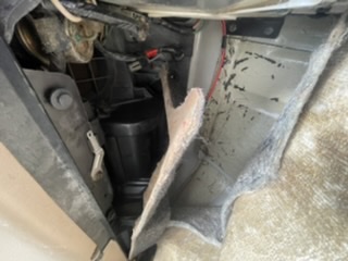

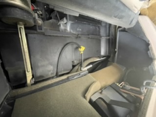

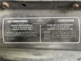

Hello folks,

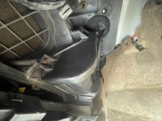

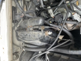

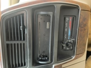

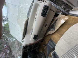

I just picked up a stock 1989 bronco II. One of the many things I wanna do to it is reinstall AC under the hood. It’s partially there already. I believe everything from the firewall into the cab is still still there.
So I want to add a new compressor, lines, condenser, and whatever else needs replacing/upgrading. My problem is figuring out whether I have factory or dealer installed AC.

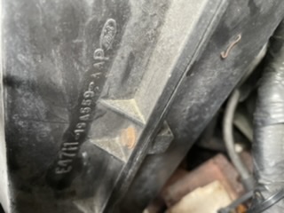

I’ll post pics here. Seems like the filter dryer & exp valve often indicates dealer installation, but all the air ducting in the cab is solid plastic and seems factory. Totally confused, please help!
Thanks so much!
Re: 1989 BII Dealer or factory AC? Help identify please.
That all appears factory to me, but I don't have anything to compare to. I don't think dealer installed A/C was a thing on the Bronco II's. Should be pretty easy to source a lot the parts at a junk yard.
