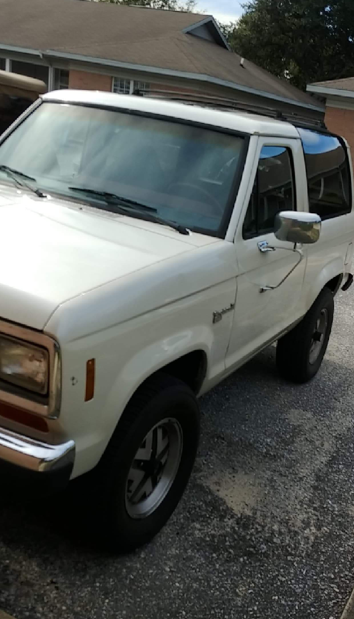

just picked up my 86 bronco xlt with the 2.9l v6. Not sure what the plan is for it yet but ive always loved these little trucks since it was the first vehicle i ever owned.
