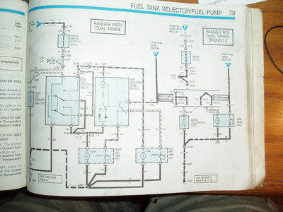

Hi Folks,
I am trying to revive an old 1988 Bronco II for someone. It has been parked for a couple years, but DID run fine. Of course, now it won`t.
I dropped the tank and cleaned it, installed a brand new sending unit with new pump, filter sock, the whole deal.
It does not get any fuel to the engine. Both pumps ARE energizing.
I dis-connected the fuel lines at the filter, nothing, at the high pressure pump, nothing, at the water separator canister, a little fuel dripped out.
I disconnected the outlet line at the tank, had my son turn the switch, and it sprayed fuel past the rear differential.
NONE of these fuel lines were disconnected while it sat. The system was closed/sealed.
It will run for a few seconds on starting fluid, so it will run.
Any one have any thoughts on this?
Much appreciated!
