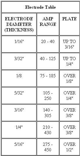

Well I didnt get the extra set of arms. The guy I got a TON of stuff (from for nothing) I didnt feel good about asking for them. I will get one or more the next time I goto the junk yard to mess around with. I think I have found that with 7014 1/8" rod and my buzzbox set at 130amps is perfect for penetration and a good looking weld. This took me forever to try this all out....

You guys should step up to a little bigger rod. I think I use 3/16 7014 for most stuff. With 7014, you want to make sure everything is clean. 6011 is better at cutting through gunk.
7014 doesn't penetrate very well compared to the 60 series rods, so prep work is very important.
FYI: to decode the welding rod numbers, on a 7014
The 70 is the tensile strength of the rod.
The 1 is the position the rod can be used in
1 - any position
2 - overhead and flat
3 - flat only
The 4 is the type of rod, and if it's AC, DC or both.
