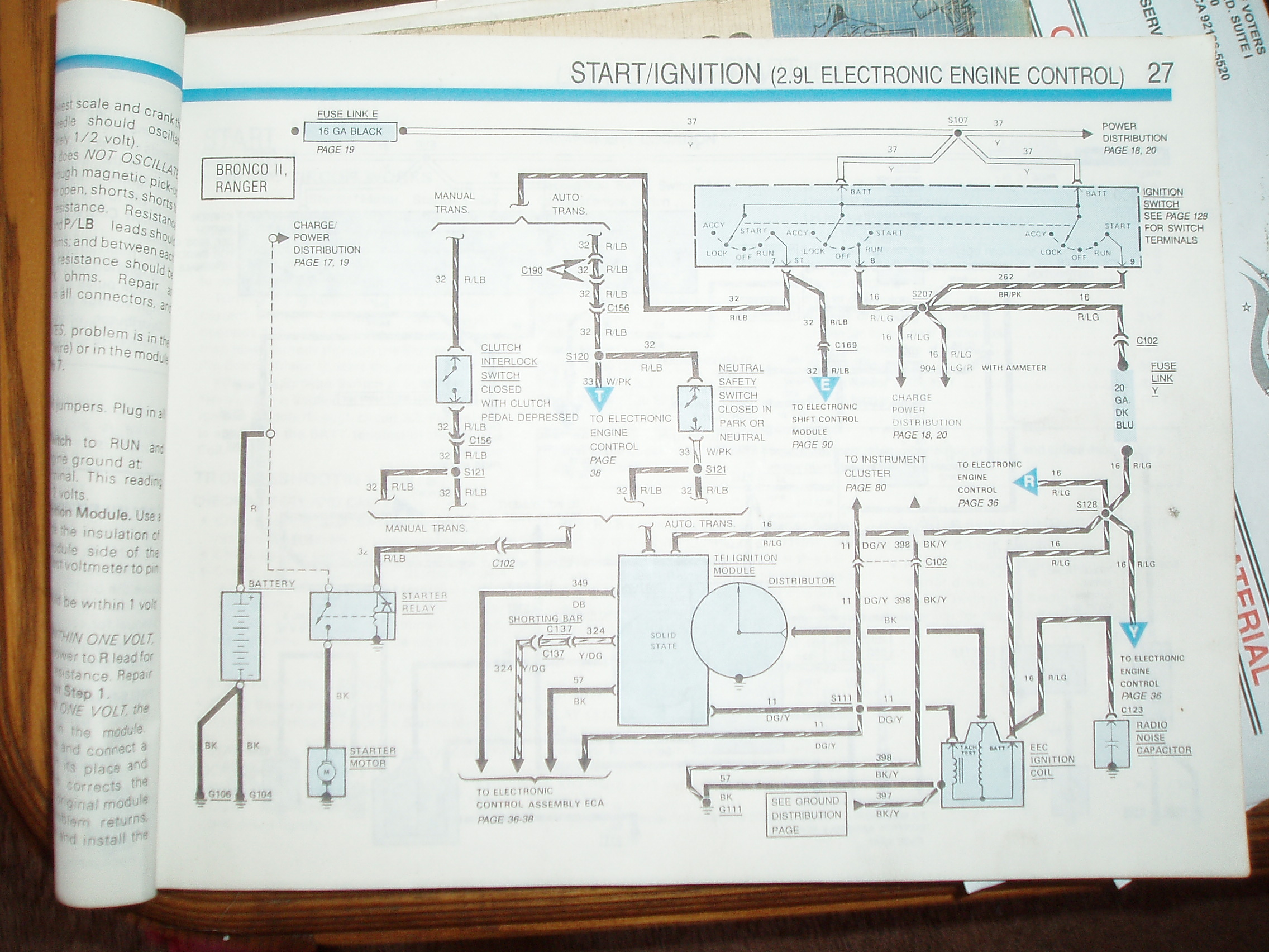

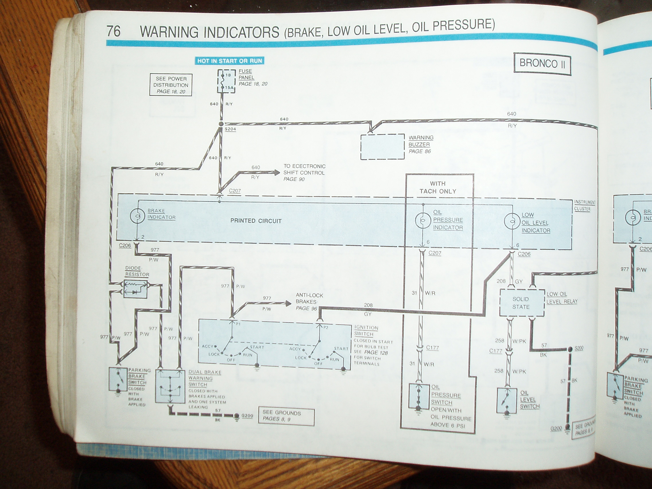

I've done it on other Ford products, not a BII and it was just a plug in. You may have to change the oil presser sender as it will be a light instead of gauge type. The schematic I included is for a 88. 89 will be different

drofman wrote:I've done it on other Ford products, not a BII and it was just a plug in. You may have to change the oil presser sender as it will be a light instead of gauge type. The schematic I included is for a 88. 89 will be different

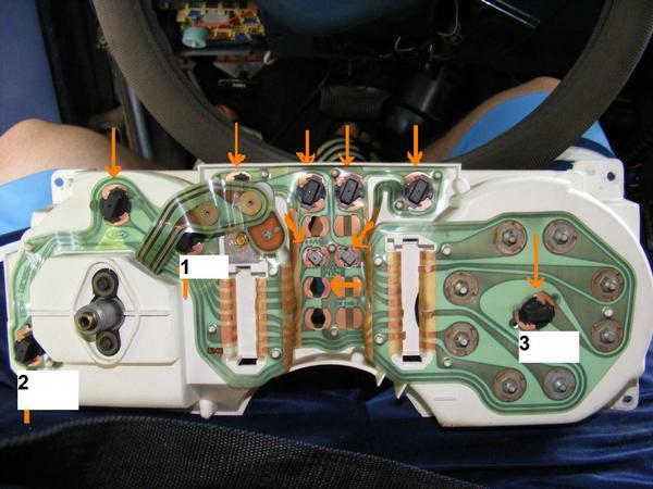

I just took out my Cluster out to change to LED lights (works bitch’n) Wished I took a picture of the back of my Cluster but if you look at the picture below #3 (non-tach) that’s the side of the Tach. If the Tach side connector loom wiring has wires in the void (right side of picture connector with only 5 connections to the circuit board ribbon) then it should work. If the loom doesn’t, then I’m wrong and wouldn’t be the first time I have been. On another note, the LED lights really brighten up the dash lights for these almost 50 year old eyes. I got them in blue and they look cool. I got them from http://www.superbrightleds.com and the part # is WLED-X6 and you’ll need 3 for non-tach and 4 for tach. Again, sorry if I misled anyone if I was wrong.

Damn, I can't post the pic cause it .bmp if someone can tell me how to I'll change it to jped
drofman
Posts: 487
Location: san dirgo
Re: tachometer
Post by drofman »
got it, smater then I thought I was
