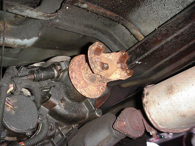

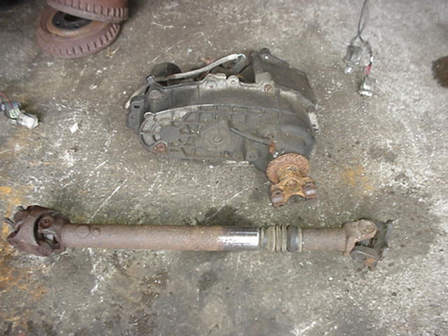

find a 91/94 xplorer and grab the front drive shaft AND the yoke from the transfer case. its a double cardan and its a bolt in
xplorer yoke.
i had to shoten the shaft cause this was going in a B2 with a 146 tranny
xplorer yoke.

Got the front drive shaft out of the donor truck 2 weeks ago. And my buddy started on the adapter:
Started with this:
And just need to index and tap the holes:
Started with this:
