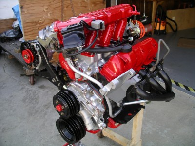

Just installed new motor. All new parts. Runs and idles, Gutless under power. Checked & found #5 header not hot. Checked spark with timing light. Swapped plugs, wires, injector, computer, distributor with known good parts, some from running cylinders on this motor. Still same issue. Plug smells dry, no gas. I can hear the injector clicking using scope. Sounds same as the rest of working ones. Driving me nuts!! I have ohmed out the injector harness. I dont have a noid light. Any ideas?? Seems if fuel presure low I would have issues on all 6. :wtf:

I have changed the injector with a known good one from the #4 port. I picked up noid light and we have pulse. Fuel presure maybe? Im going to pull the injector to make sure nothing left in injector hole on intake manifold. It was powder coated. I am so ready to get wheelin. I take it to the dunes for the wife to have fun with. Intake valve not opening?

Ok I inserted clear hose onto #5 intake port, did not have squit botle, put in some gas. It gets header hot when started. Only thing I have not changed is the harness for the injectors. Gonna do it now. How much fuel presure on the injector before it will squirt gas? I have a new injector I have hooked up to harness and have a gas line to it with 20 psi and no gas is coming from the output. (its in a bag so I dont catch my rig on fire when it does decide to start squrting fuel.) :frown:

held throttle body open and slid it in the right side down to the middle port and put in just enough to get a couple strokes to fire long enough to heat up the header. It got nice and warm when it just was cold before.
