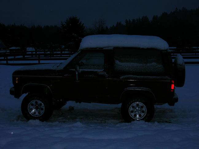

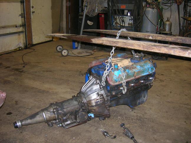

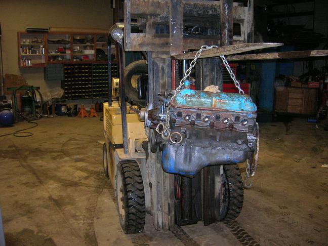

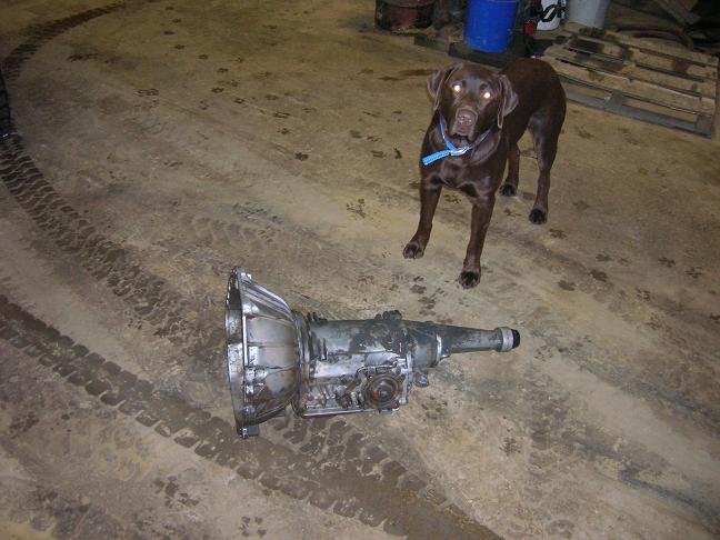

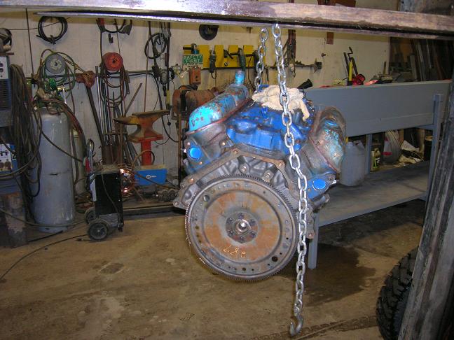

Thanks for the tips, here it is. This the day I brought the engine home and transmission.
snow on bronco.jpg (33.8 KiB) Viewed 7185 times
Ruffinit
Posts: 183
Joined: Thu Oct 04, 2007 4:50 pm
Location: Muscatine, Iowa
Re: C4 tranny
Post by Ruffinit »
Hey, the pics look great! Congrats. I have a choc lab that fetches things in also, but I haven't ever had him bring in a tranny... :eek:
WaPaul
Posts: 34
Joined: Sun Nov 16, 2008 8:17 pm
Re: C4 tranny
Post by WaPaul »
I am working on getting my dog to get the right wrench or socket, then I will be on to something.
A little sandblasting and paint on the outside, and new lifters and a carb overhaul. I will tear it down and do a complete rebuild and a slight build next winter. The small oil filter is just on there to plug the hole, and let me turn the oil pump over and build oil pressure to see if it is all working right.
