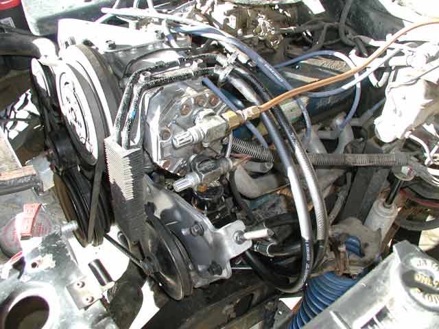

I just got my OBA hooked up last night after being without it all summer. I had to find new brackets that were compatible with my saginaw power steering pump.
so lets see it!

Check out the sweet little powersteering cooler I found.
man, that looks awsome!
is that the ARB air compressor?
did you make the air tank?
how much does the powersteering cooler help?
hey that look's like my P.S. cooler. i like the way you mounted it.
i was looking for a place to mount mine over the weekend while i re-position the tranny cooler so i could get more air flow to my radiator. what happened to the fire extinguisher?

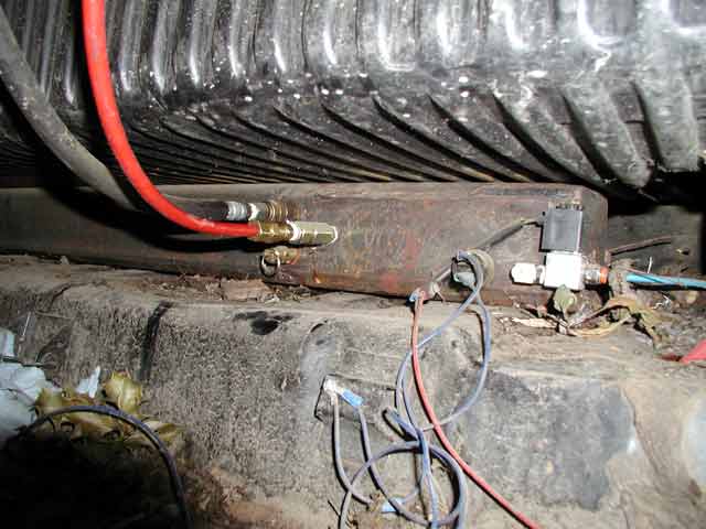

DBrown wrote:man, that looks awsome!
This is new to you?
The ARB compressor is a POS electric thing. Takes about a year to air up one tire.....literally 20 minutes.
My A/C pumps air my 36's from 5 PSI to 25psi in a minute at idle. If I kick up the rpm, it's really fast. We're talkin air tools, no problem.
The tank I built last year out of some box tube. I figured it for about 2.5 Gal. About the same as the fire extinguisher. I can drill and tap as many ports as I need. Fire extinguisher worked great, but took up too much space in the engine compartment, and I couldn't attach all the stuff I needed to.
The compressor I just installed is the most popular YORK. The york is popular because it has a crankcase for oil, where as the rotory style are lubed via the freeon. I ran the hell out of my rotory pumps with no problems. I wouldn't hesistate to run whatever bolts up.

no, I set up the A/C on the 4.0L but I havent seen that compressor. I didn't think that a factory 302 a/c set up looked like that. I still have the fire extinguisher tank but it does ok, for what I use it for.
so what about the PS setup? that I haven't seen.
